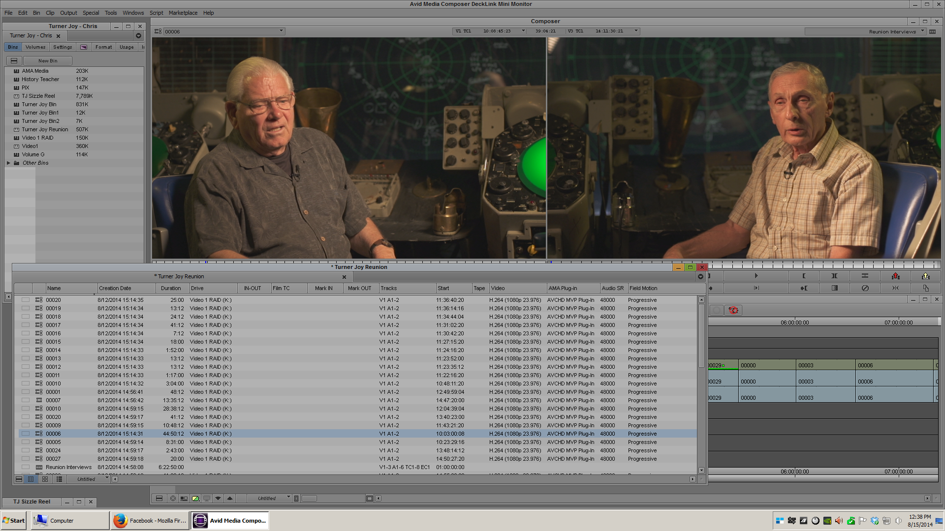

In Avid you will need to open the bin where your footage is located and view it in list view (not thumbnails or script view). Turn on a field called "Field Motion". This will show you how Avid is seeing the footage (progressive or interlaced). If it is seeing the footage as interlaced you can manually set it to progressive.
This should take care of the problem.

If you click on the "Field Motion" field for a video in the bin you should get little popup. You should be able to select from the options in the popup. You will have to do this for each file in your bin.
I'll look and see if it can be changed in a batch method.

I just selected a bin full of clips and changed them from progressive to interlaced by clicking on the "Field Motion" field and changing one with the others selected. They all changed together. I am running MC7 so your mileage may vary if you are running an earlier version.

Thanks Chris, that seems to have done the trick. Much appreciated.
