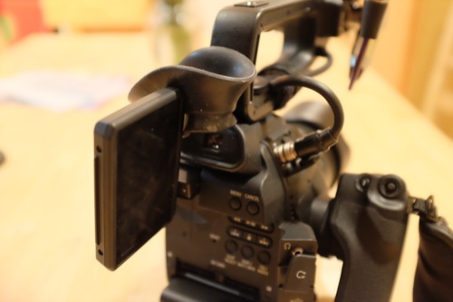

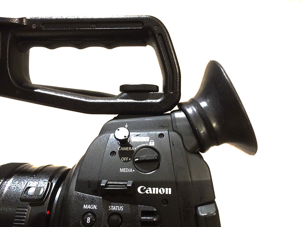

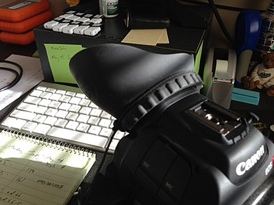

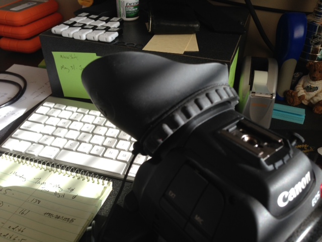

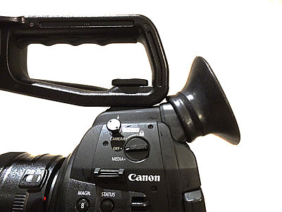

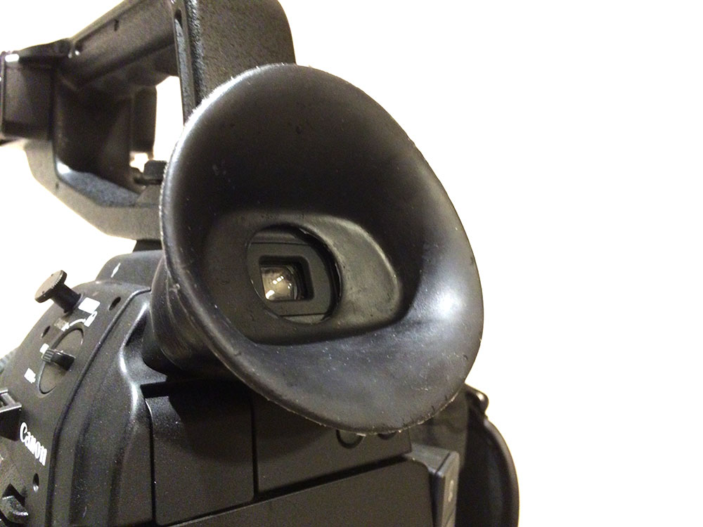

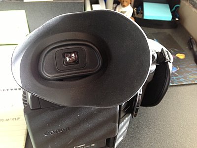

Recently bought the Canon C100 and so far loving it. Using the viewfinder, I found that I could use it no problem. The problem was the light leak around my eye that made it difficult. Having a Zacuto Z-finder nearby I pulled off the eyecup. It fit the C100 perfectly and eliminated the light leak. Looking it up at B&H, I found it for $10.80! A quick fix for those looking to improve the viewfinder.

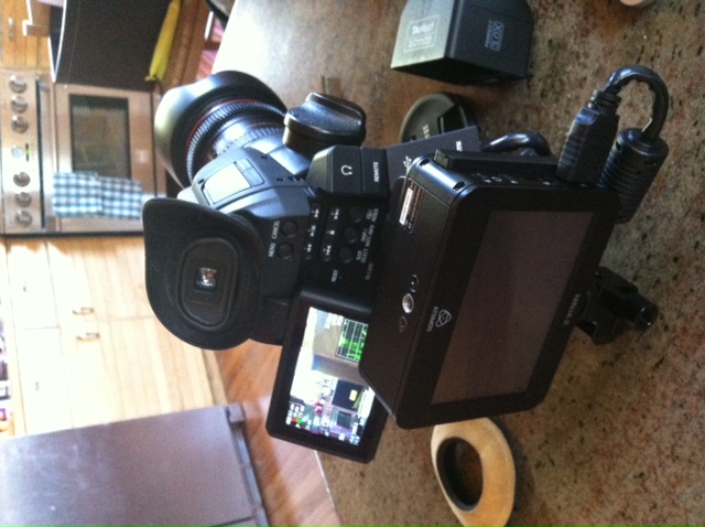

I have been building my C100/ Ninja2 kit today and was just getting to VF cups. (ergonometrics R US these days)
I have an eyecup off my cheap Perfect 3.0X LCD loupe which works but doesn't appear to cover as well as yours.- (Amazing price from Zacuto! Now if they would only sell the C100 handle relocator for $50.)

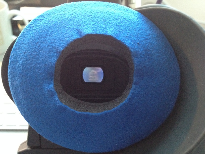

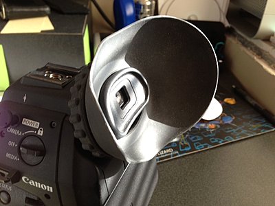

I've tried the Bluestar cushion extra small round. It works well, the zacuto covers my eye a little better. Great stuff about getting the viewfinder in check.
Also checked out The Location Crew. Looking up a PD170 eyecup, they want $65.
Picture attached: Bluestar Round Extra Small cushion.

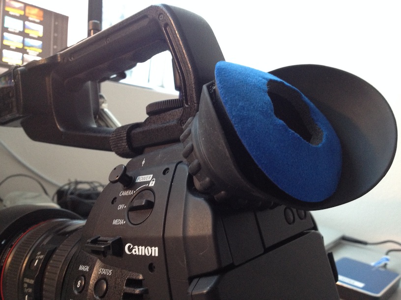

Here's my simple solution.

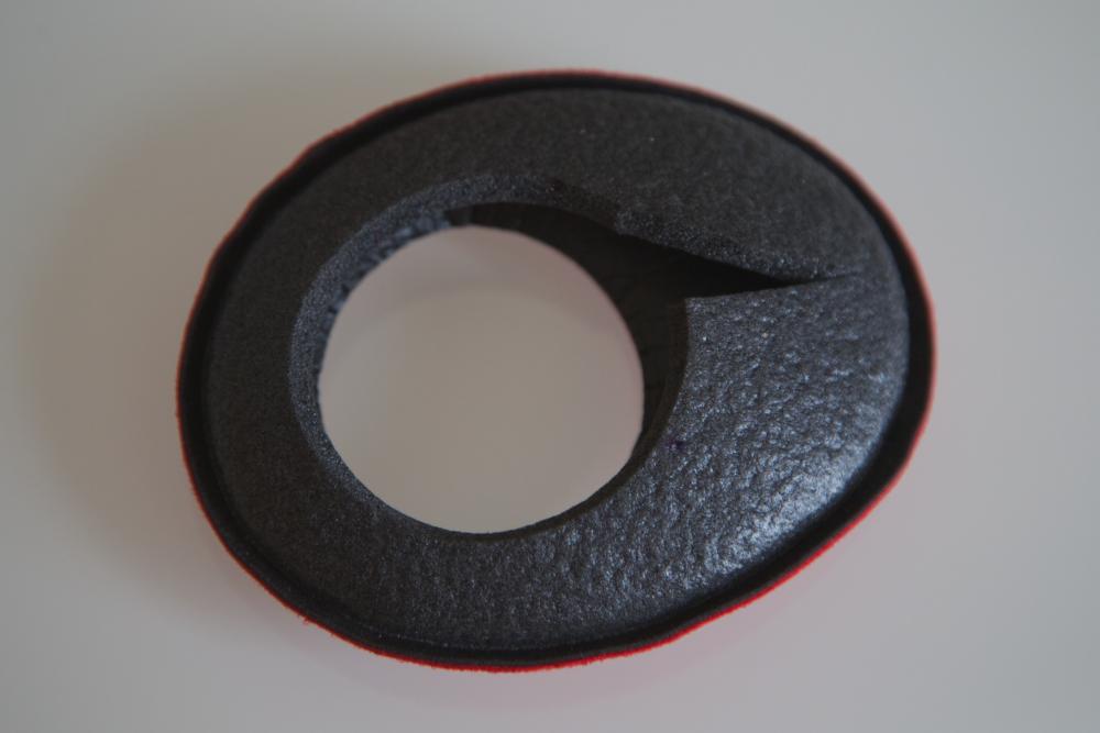

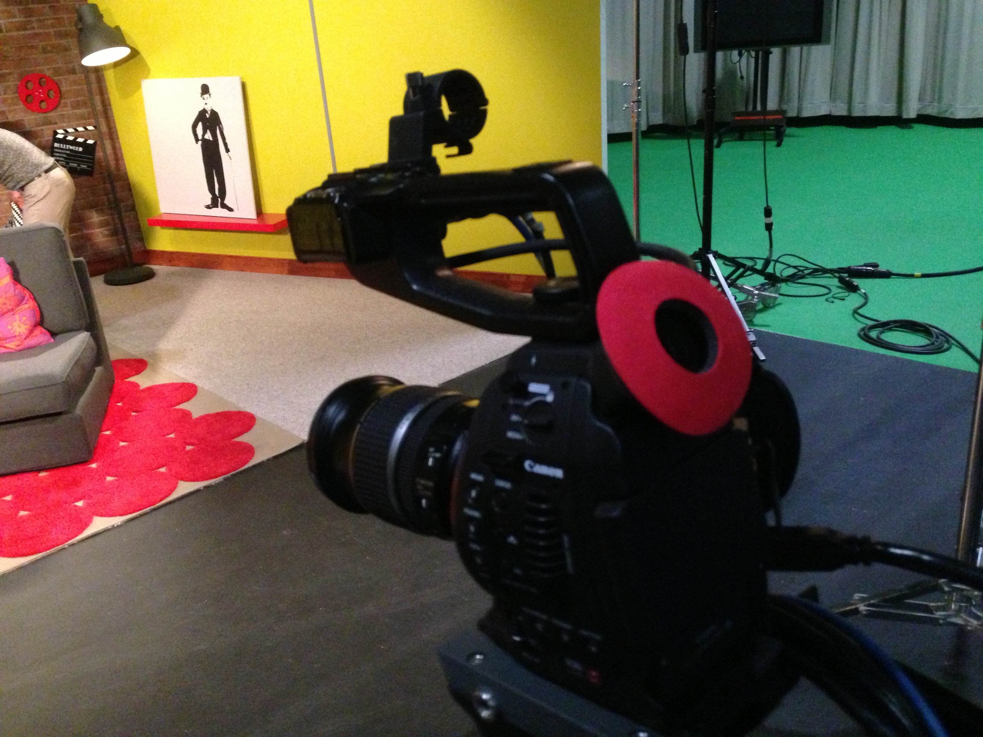

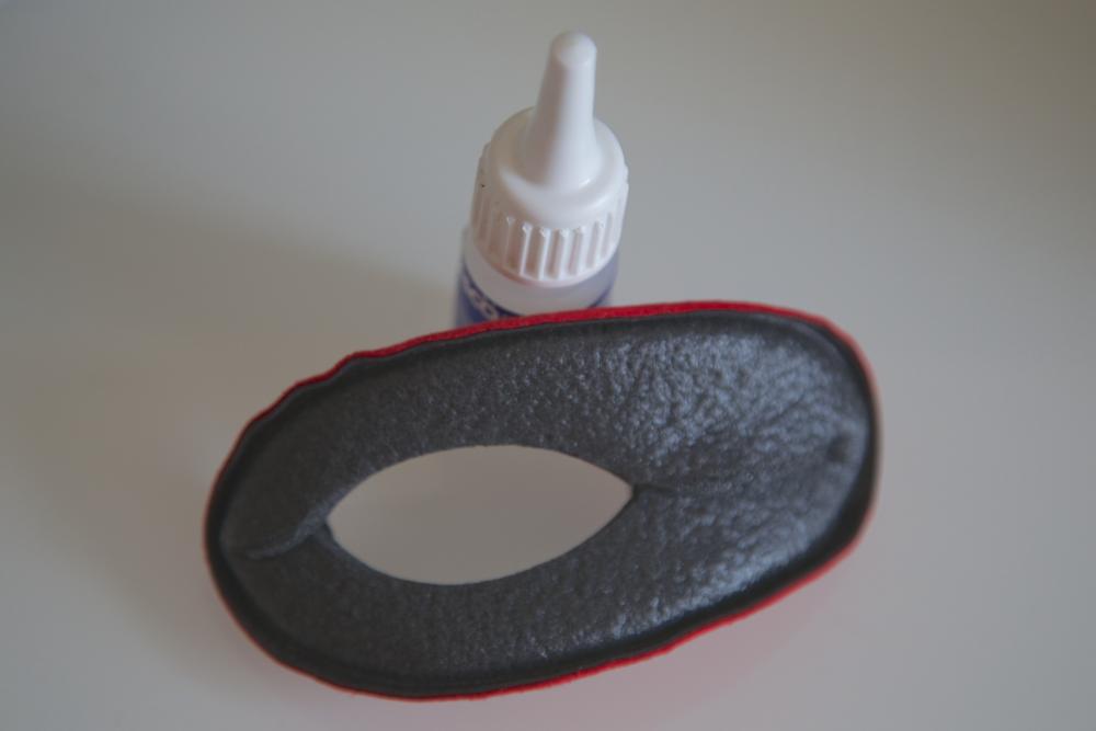

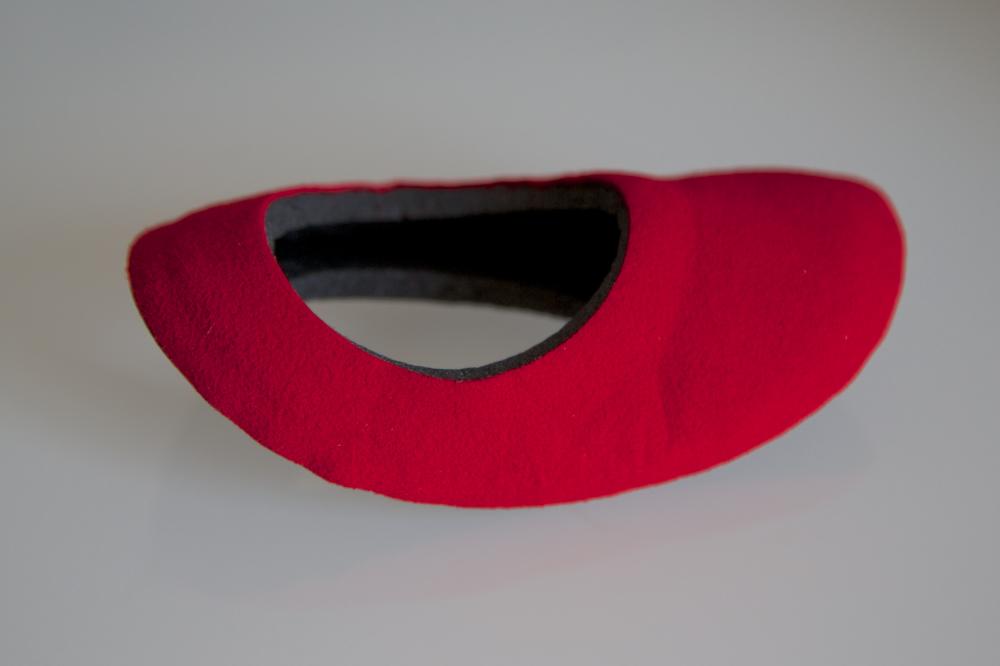

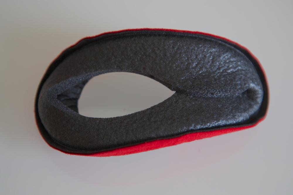

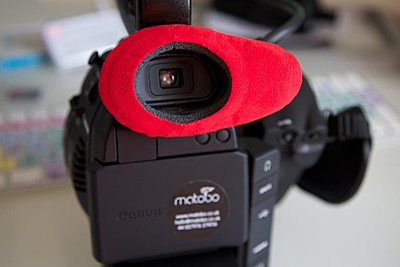

Just taking advantage of a bit of vacation time over here in the UK and thought I'd post some pics of a modified Bluestar Oval Long Eyecushion (Bluestar Oval Long Eyecushion) that I cobbled together a few days back.
The dealer from which I bought the cam, Proactive, are talking with Canon UK about an official solution and I'll update if they come up with anything. But, in the meantime, with a pair of scissors, some superglue and a spare 5 minutes, the Bluestar fitted the C100 pretty darn perfectly.
1) Cut the elongated end:
http://www.dvinfo.net/forum/attachme...1&d=1370287007
2) Fold over and glue.
3) Cut the other end and do the same:
4) The chamois should now sit proud like so:
5) Bob's your uncle:
You could add a thread stitch at each junction for longevity, but the glue seems to hold well on this foam material.
There's absolutely no light leak now - just a big distracting red blob on the back of the camera, but Bluestar do them in "natural" and grey finish too.

Thanks for this thread, it's been so helpful. I used the Zacuto eyecup for a while and really liked it, but wanted some more padding. Turns out the Bluestar eyecup and Zacuto combo makes for an awesome eyecup!
I cut up some velcro to attach them to each other, so the bluestar wouldn't fall off, but some sort of glue would probably work better.
