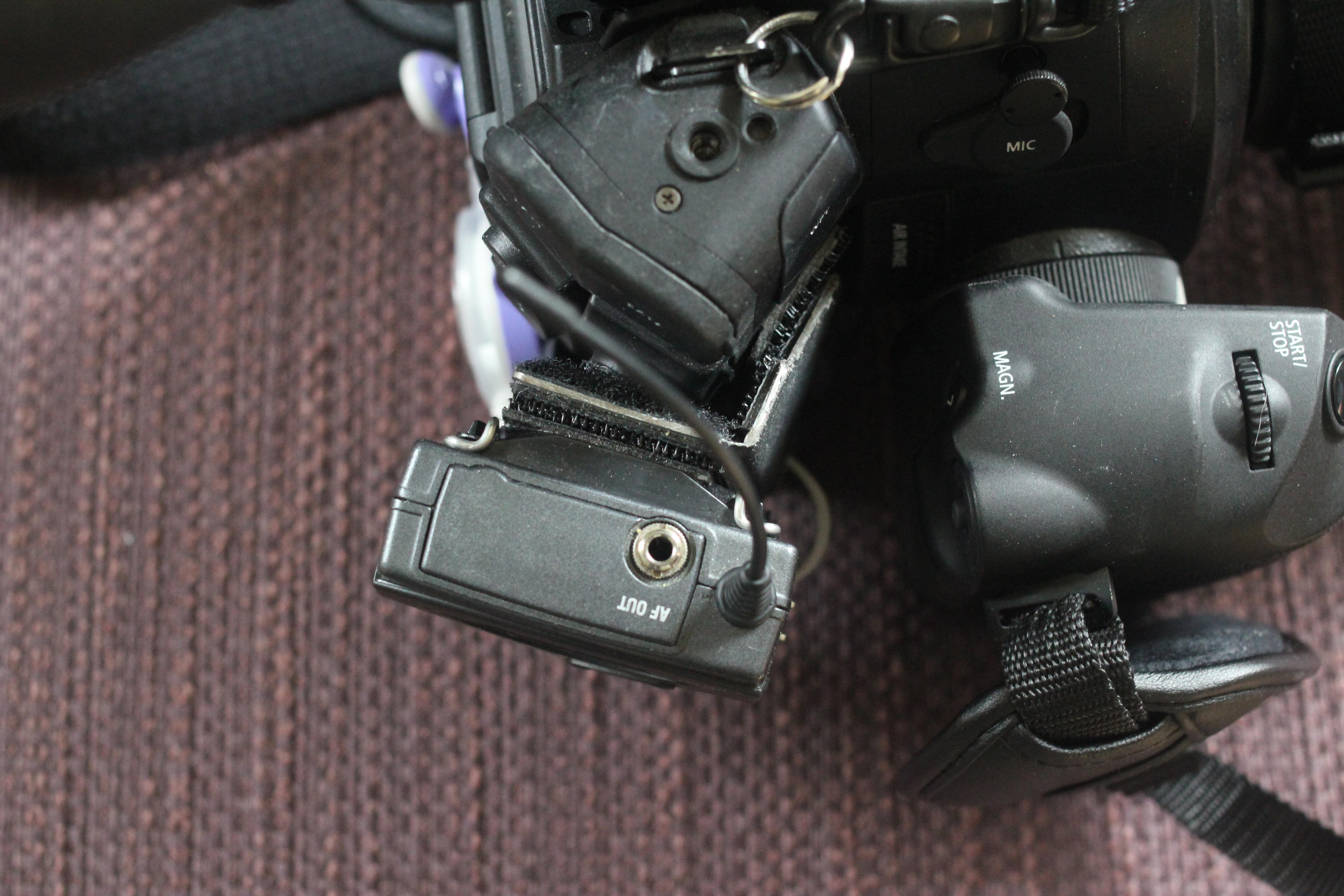

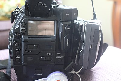

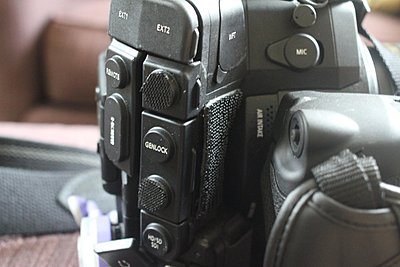

I only have one mounted. But the best solution I found was to get a right angle at the hardware store and mount it on against the BNC jacks (since I never use those), but attached to the side using 3m dual lock. I also have a couple velcro spots on top of the BNC jack covers otherwise it will lever off the dual lock connection when bumped. There's still enough room to get my hand around the handle.
I don't think it would work stacking two receivers, but in case it's useful to someone else I attached photos.

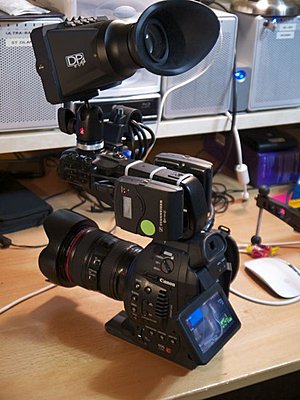

Looks pretty nice and compact for one wireless. Here is what I rigged this morning. Not perfect but not bad either. At least, the camera is fairly well balanced and the wirelesses don't interfere with the camera handle.

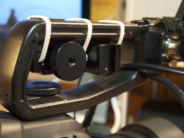

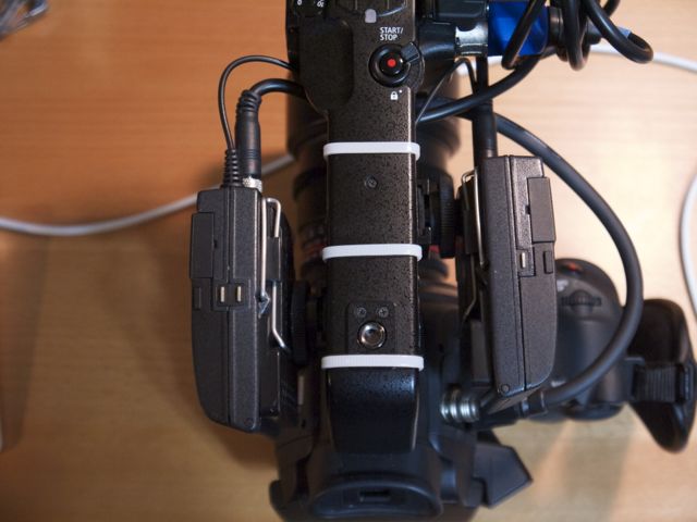

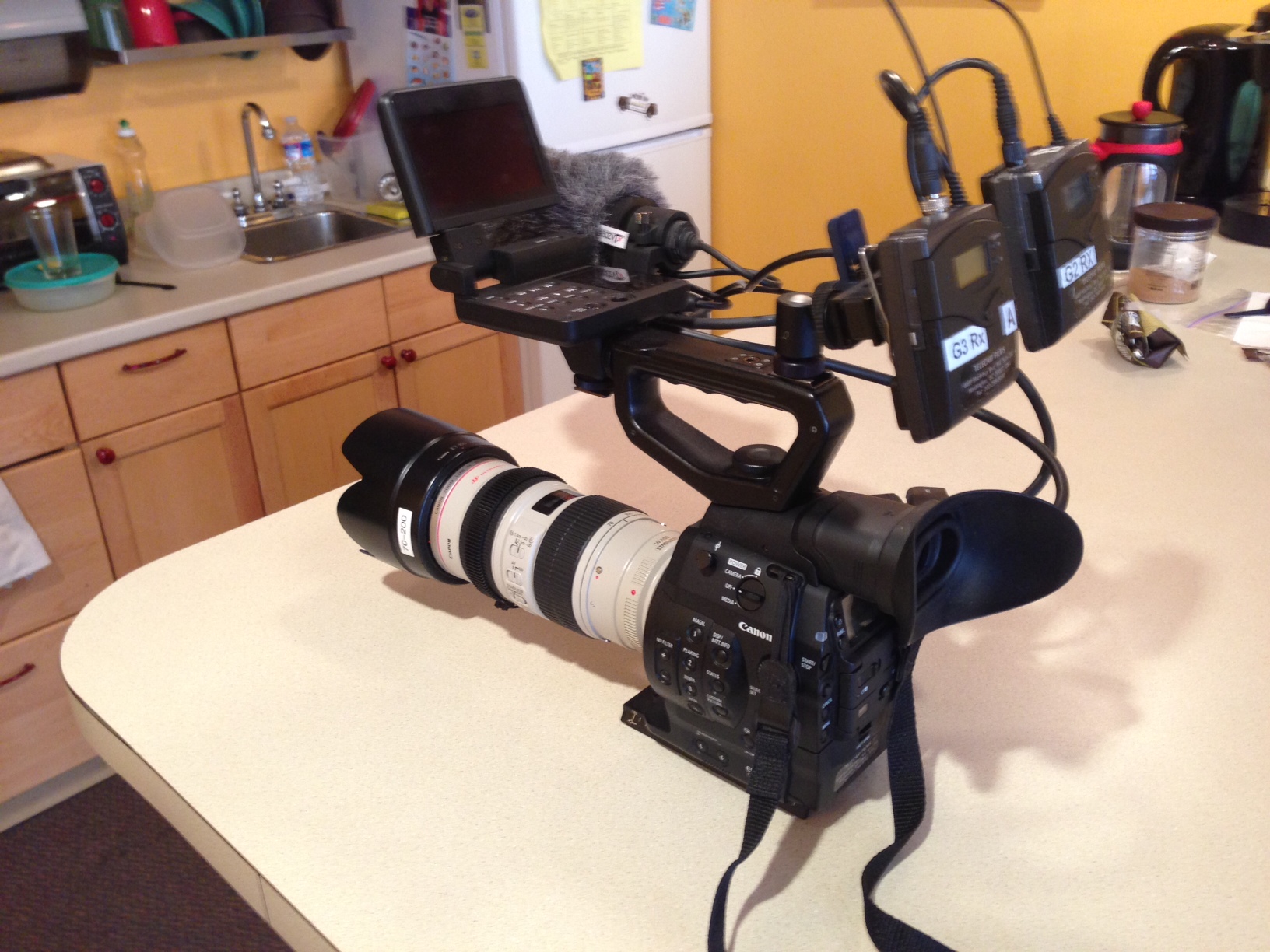

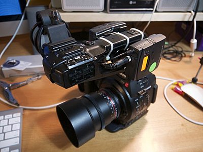

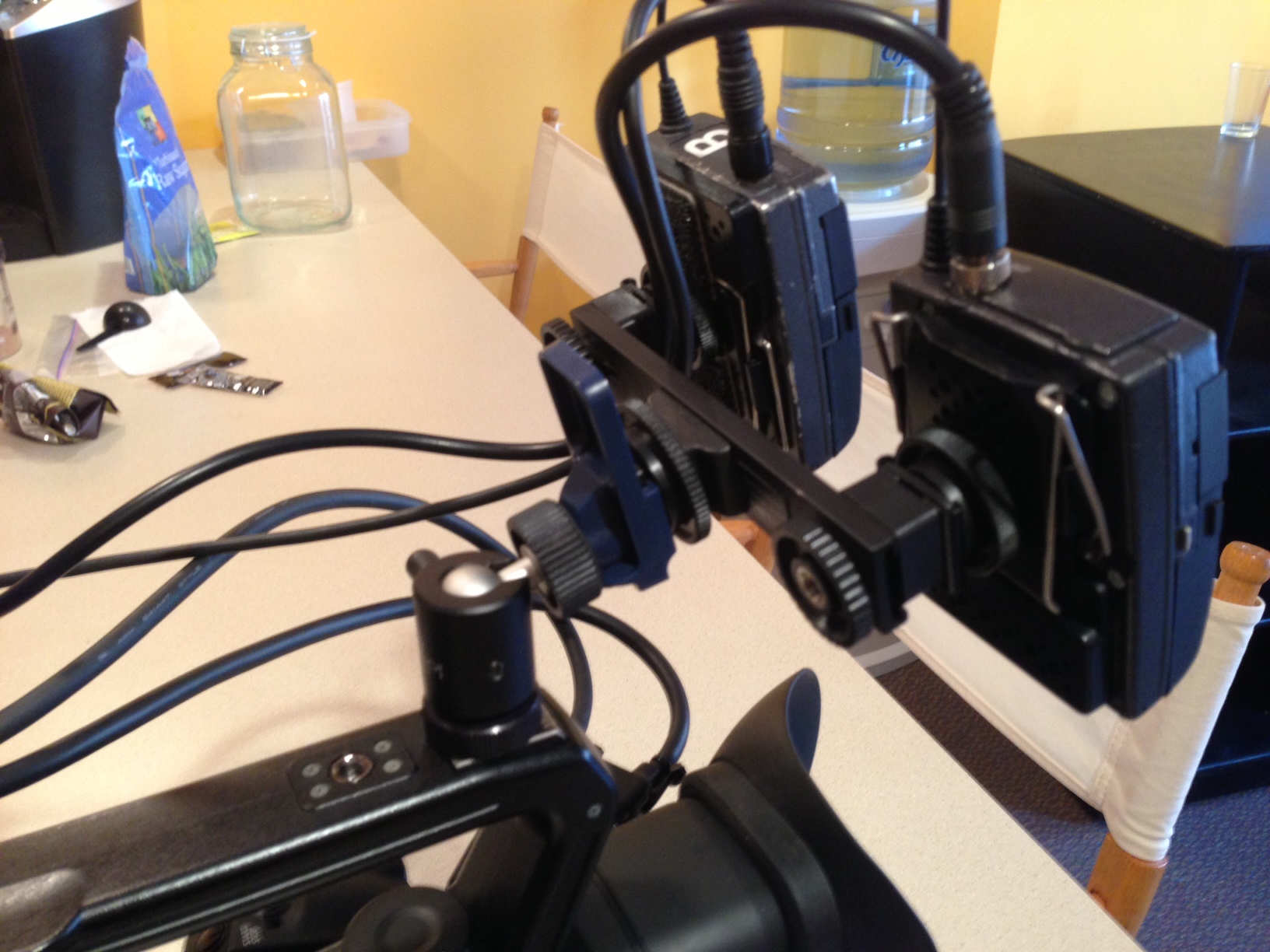

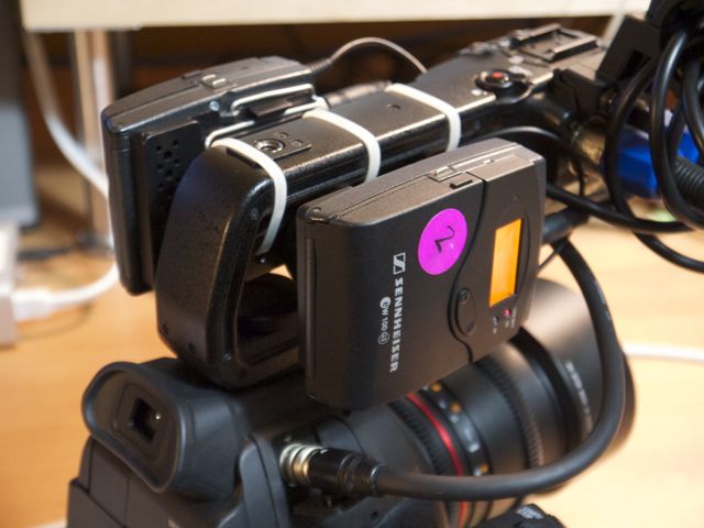

I think I found another solution to mount two wireless receivers. I have a run-n-gun gig coming up and need to use the top hot shoe for a monitor. I wanted to keep the receivers out of the way, so I bought a handful of parts from CoolLCD.com and put them together to sling the cold shoe mounts under the handle. The three zip ties make it surprisingly solid, definitely not going anywhere. I think the "final product" will have black zip ties. It cost me about $20 in parts, but the result seems to be pretty good without anything hanging off the camera at odd angles. Finished rig shown in the final photo. I'm satisfied.
