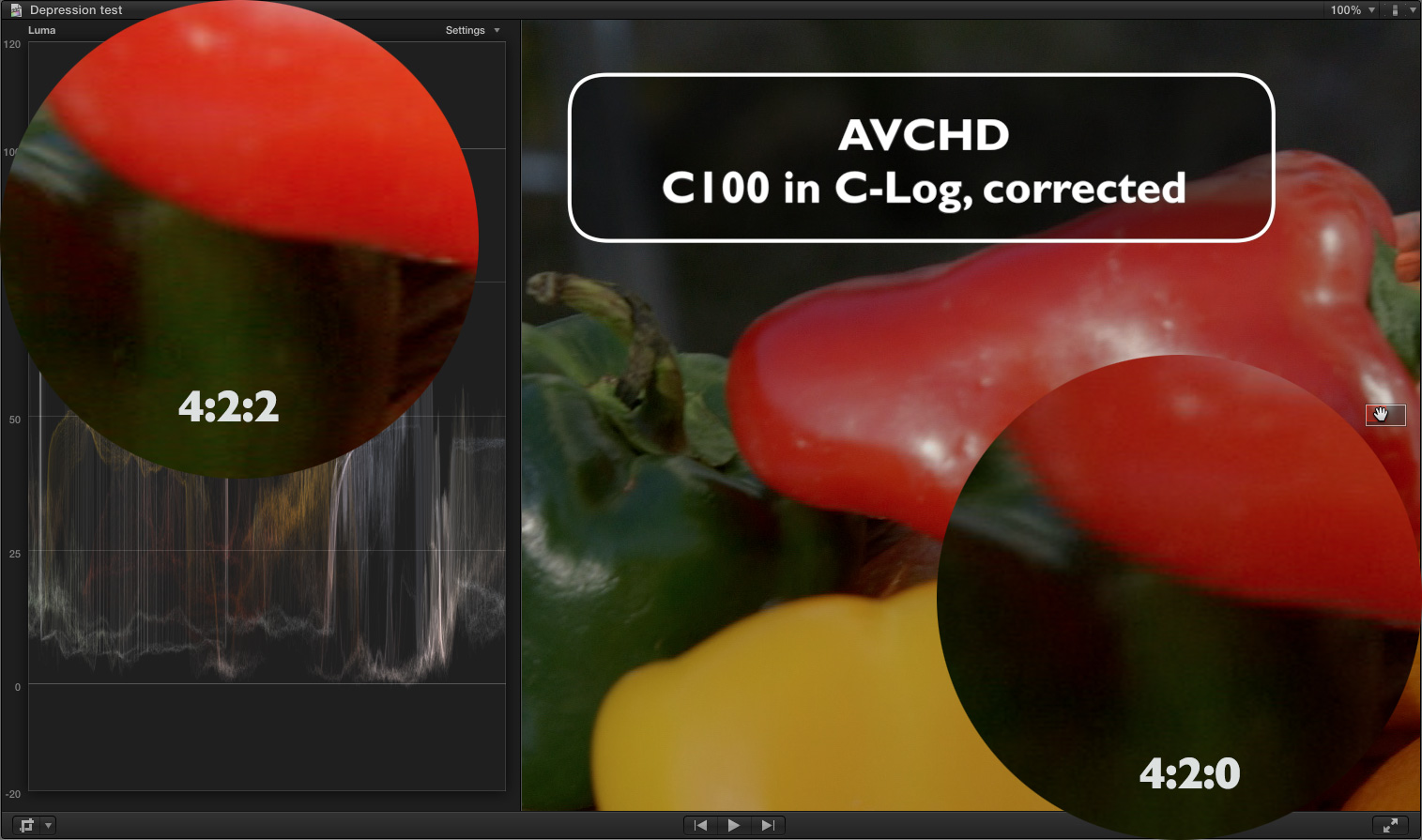

But how bad is this interlaced problem with PsF?
You have to be looking close, and hard. I've had a few people tell me that I'm going totally OCD over this but there's something about handing over footage to another editor that makes me do this.
I'm working on a hypothesis: that - unlike the FS100/700 - the C100 is capable of creating an image that contains so much detail that the AVCHD codec can sometimes run out of puff.
Now, usually the AVCHD codec is so good, it's really hard to visually tell the difference between it and a parallel ProRes 422 recording (spent yesterday afternoon trying to break it). Here's some preliminary stuff:
4:2:2 vs 4:2:0 on the C100
The second 'flip/flop' sequence (the eye) demonstrates the interlace squiffiness. So, the grainy image is the first frame, I'm confident that it falls on an I frame. The following image is the next frame, which would be a P frame. It's in these 'pairs' of P frames that show the pseudo-interlacing when - and only when - the codec is under a lot of stress (like 18dB of noise and hand-held wobble-cam, or a really detailed image with lots going on).
But I am still amazed at the lack of visible difference between the 4:2:0 and 4:2:2 from the C100 when the scene isn't too demanding. I tried 12 cycles of recompression to the XDCAM 422 codec on the pepper footage with no discernable quality loss, and that includes the AVCHD and ProRes-LT stuff within it. I was hoping to see some degradation, but this could only be seen in the WFM and Vectorscope.
The 'fishiness' of the PSF is almost completely cured by converting the AVCHD to ProRes in FCPX, too. So it may be something to do with the way FCPX is interpreting the AVCHD - flicking through rushes at 200% magnification, frame by frame, looking for interlace artefacts in what should be progressive frames is a bit obsessive and sometimes 'you see what you want to see'.
One thing - ONE THING - which we all see regularly, and is a true 'Mark of Cain' in any 4:2:0 footage, is a sort of sawtooth pattern along the edges of oversaturated reds (see attachment below), though it crops up in any area of strong colour. Nature of the AVCHD/XDCAM-EX beast, though the 'pointy' version seems to be unique to the C100.
BTW, integrated C100 footage with Sony F3 and EX1 rushes with no issues - keep sharpness down (!!), use CineGammas (1,3 ad 4), don't touch the colour stuff, use WDR on the C100 - they can be brought together very successfully. Recently had a comment from an editor that my C100 looks VERY like the F3 on XDCAM codec.
I see this on footages from my new C100 and I solve this problem (on WIN7 and AvidMC/Symphony 6.5.2) with reexport to XDCAM HQ codec (VBR 35Mbps 420, 1920x1080). Re-Import these files is about several second (Fast import on AvidMC) and result is ok. But I use this method only for selected clips.
I think that this problem is an C100's AVCHD problem (the problem exist on various editing softwares).
