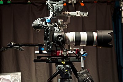

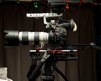

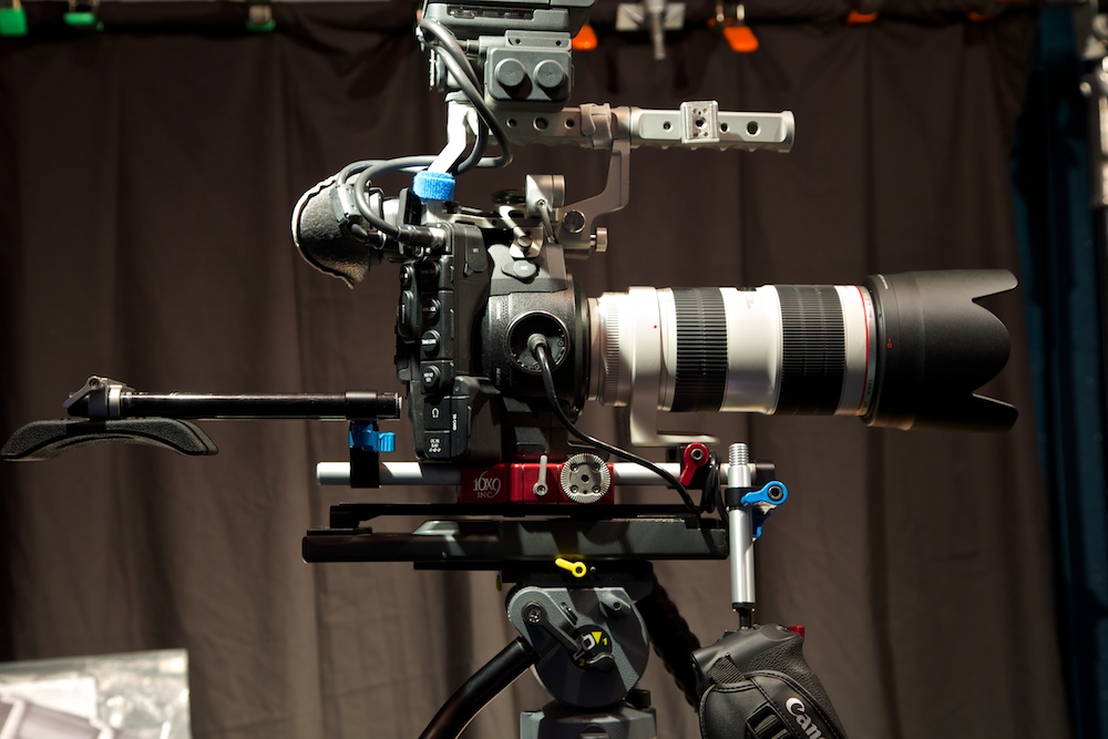

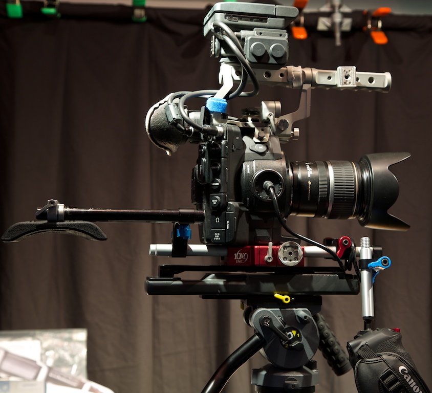

Here you go a few pics that I took of the 70-200 both sides and the 17-55. The 70-200 as you can see does not line up with the bottom of the camera base it is higher.
Sorry the bottom pic is labeled as 70-200 but is the 17-55.
Hope this helps.

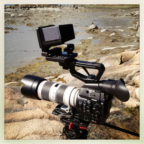

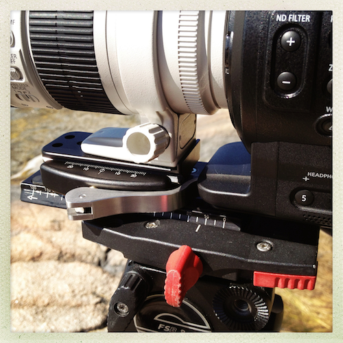

I would always support this lens. It's a given in the stills world but I often see photos of people shooting video who do not. To not support it feels like an accident waiting to happen.
FWIW, here's a blog post where I am using RRS quick release equipment, the 70-200 and a 1D Mark IV:
Stopping Short of Rails | Learning to See
Below is a similar setup with the C300 and 70-200.
Both setups, C300 & 1D Mark IV, use a RRS 80mm quick release clamp, the B2-LLR-II. The clamp works well but it can be a touch snug when unlock the C300/70-200 combo from the QR clamp.
Kessler makes a really nice new clamp, the Kessler Kwik release. What it adds above and beyond the RRS clamp is that it's a bit beefier, it has a snap-in setup, and it has many more mounting holes.
Kessler Kwik Release
The Kessler clamp is compatible with the RRS rails but there is an issue in that its lever doesn't have enough clearance when the 70-200 is used. The work around would be to loosen the 70-200 lens foot collar and rotate the C300 body out of the when locking down the Kessler clamp.
See post below for more info and more links.
C300 & Canon EF 70-200mm f/2.8 L IS USM - Lens Support?-img_5262.jpg   C300 & Canon EF 70-200mm f/2.8 L IS USM - Lens Support?-img_5263.jpg

The RRS is very strong. The rating is at least 50 lbs but it may be higher. The easy on, easy off, is what I was aiming for. I have been trying to keep the setup (dslr & C300) as slr like as possible (avoiding 15mm rails, follow focus, matte box, etc.) and still quickly move from tripod to monopod to slider to hand held, etc. This allows for that.
