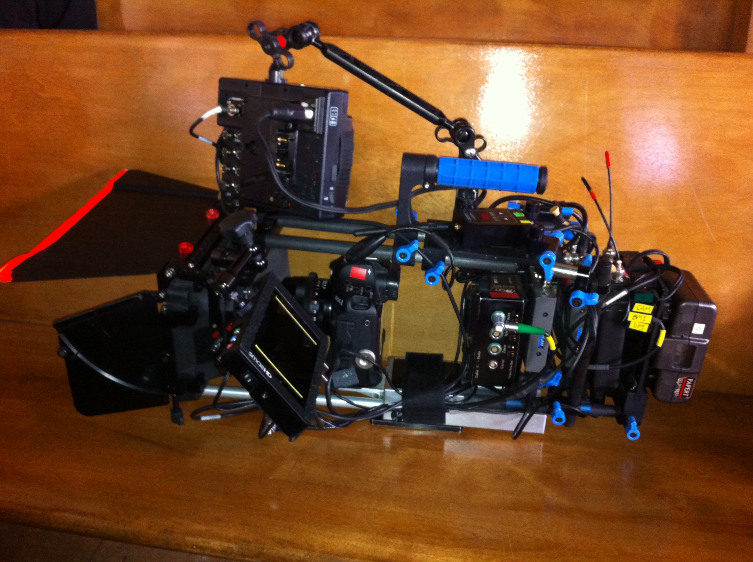

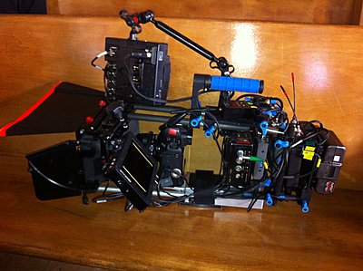

Since I asked "where would you add stuff to this", the pictures in that link answer it. And I think they show that it's a haphazard affair of attaching things to the sides, to the top...again, I think the overall design is a cute idea but I don't think it's real-world practical. In the film days, especially shooting with an Aaton handheld which was generally in a doc situation, there weren't as many bolt-ons as there are now. I'm sure there are those who keep their configurations simple enough that this wouldn't be too much of an issue, but I know for me it wouldn't make sense.
Below pic is from last year--in this instance all but one of the components at the back would still be required if there was a C300 up front.

Great picture Charles. I wouldn't like to have that lot on my shoulder.

Crazy picture Mr. Papert!
That franken-rig in the photo looks about as un-ergonomic a tool as you could imagine. How are you supposed to hold it (for long periods)?
I often wonder when I see images like that, when you consider that the cost of accessories often far overshadows the actual DSLR in the middle of it all, why the crew didn't just rent a better camera to begin with and do away with all the workarounds? I kind of always thought the whole benefit of a DSLR was the size and cheap cost.

Simon and Mark: that was actually studio mode--for handheld we added the O-grips and possibly lost the 8" AC's monitor. In terms of ergonomics, that is actually a perfectly good form factor, because it sits on the shoulder, just as the Ergocine unit does.
The key to good ergonomics in a handheld camera is to me that it is balanced so your hands don't have to support any weight. I would much rather have a 15 lb camera on my shoulder than a 5 lb camera in my hands. Some might think that a shoulder cutout is critical. I feel that it is fine as long as the camera is actually balanced in the center of the cutout. I've long eschewed the aftermarket rigs that jack the camera up needless inches and added a shoulder pad that is way back from the center of gravity. You want the weight low and centered, and this eliminates both of these with little gain. With these setups I used a simple memory foam mousepad wrist support with velcro on the bottom; I could stick it directly under the CG of the camera and away we went. One thing that wasn't available at the time was a good viewfinder solution, but I had made a simple coroplast box around one of the loupes that turned the DP6 into a good but oversized viewfinder (when the SmallHD guys saw this at NAB the previous year, it led them to the DP4 viewfinder design). But: it really wasn't much of a burden to shoulder. I would suggest quite similar to the Aaton 16, to be honest!
As far as the benefits to DSLR's being cheap and small, I personally felt that the cheap part was the real key (along with, at the time, best light sensitivity of any large format camera--I used the 1DMKIV). Even with a few add-ons, the camera package was still much less than that of any large sensor camera available at the time (body and lenses being far cheaper rentals). You have to remember that prior to the F3 and later C300, there weren't any cameras that did what this did short of the high-end ones like Alexa and F35. I shot three network pilots that year with this setup and was able to use the savings elsewhere, such as the lighting package.
