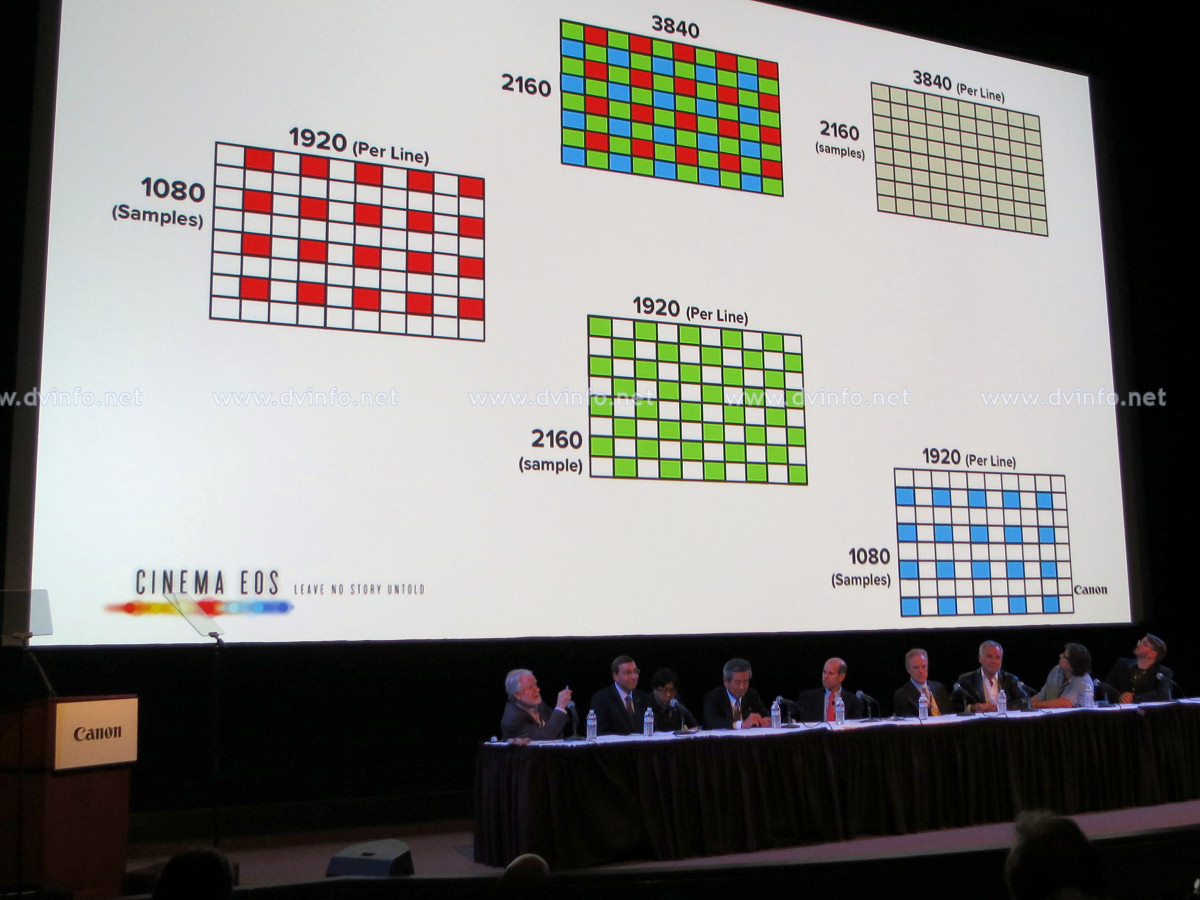

Direct 1080 read out (as with the C300) means no downconversion. That can only be a good thing.
In a nutshell, that's pretty much how Larry Thorpe explained it on Nov. 3rd at Paramount.
The short answer is that color information goes to the processor the same way as it would from a three-chip sensor block.
In this pic, L to R:
L. Thorpe, E. Peck, (translator? unk.), M. Maeda, J. Fauer, A. Krudo, S. Nicholson, F. Alcala, V. Laforet

In that case (for 4k), expect RAW recording, so the deBayering done in software.
And start saving up for Canon's version of the Red Rocket ... or a seriously powerful 12+ core PC .... or hope that your NLE adds GPU assisted debayering ;)

Additionally, if you DO deBayer the full sensor, you end up with something approaching 4k resolution (and a 4k raster). So for the future, it opens the way to an optimised dual 4k/1080p camera. In that case (for 4k), expect RAW recording, so the deBayering done in software.
It's interesting that 4K has no more real information than the 1080p output. Which is a backwards explanation of why the C300 image could/should be superior to the 2-3K bayer image like the F3.
Resizing C300 1080p output to 4K should produce about the same result as capturing 4K from SDI.
