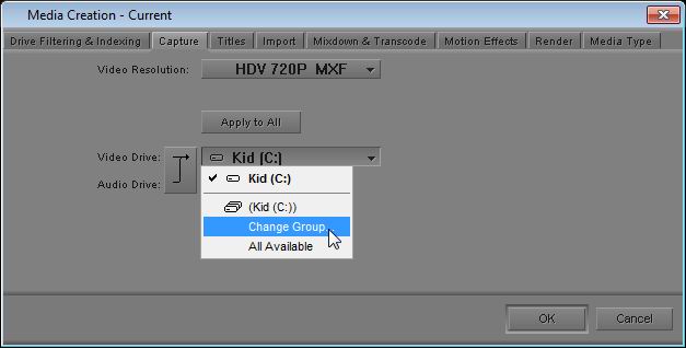

Have you tried the change group option?

That is what is so strange. I went to that tab and there are no other options but the C: drive. I guess I will have to call Avid. I wonder if it is a windows 7 bug. Thanks for trying.
