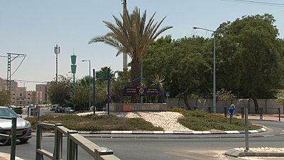

Without starting technical dispute here, I just want to show some results I got. Please observe the following two fragments: the first fragment has been cut from the original footage recorded at approx. 21 MBps, and the second one was from the postproduction movie rendered at approx. 80 MBps.
As you can see, the central element of the ornament is more evident in the high bitrate fragment.

I don't see how you put detail in that wasn't there in the first place...

I agree- you can't produce information that was not there to begin with.
However, decompressing your original footage and recoding into higher bitrate, higher level (10bit, 12bit, 4:2:2) digital intermediate codec for editing gives you more redundancy and "digital headroom" for applying extensive effects, color correction/grading, etc. and can result in a better quality image in the final delivery format. Otherwise, I doubt that there is any serious advantage.

The (additional) information does not appear out of nothing; rather it was unseen in the first place and revealed in the process of rendering at higher bit rate.
Let me take an example: imagine that we have number 25.63452985032(7)… If the brain power of a PC processor is limited to certain extent then instead of that number we read just 26. However, if the processor would be enforced somehow, we would get more accurate approximation of the original number, say, 25.635.
Something analogical goes with AVCHD video. It is severely compressed so to be played back it has to be decompressed first. Where this decompressing is taking place depends on the video bitrate. It could be decompressed completely by the processor on-the-fly i.e. during replay. Or it could be partially decompressed by rendering process at a higher bitrate and then playing back with lesser burden on the processor (i.e. more accurate = with smaller number of artifacts).

Here's the part I have difficulty with- Arkady is decompressing his raw 24mbs AVCHD and transcoding/recompressing to a higher bit rate format, then comparing the transcode to the original footage.
Is this not the same as transcoding 24mbs AVCHD to a DI such as Cineform 100mbs .avi? The transcoded footage looks great, it's 10 bit or even 12 bit, 4:2:2, and so forth, and will be more "lossless" downstream.
But even the companies who develop and sell DI software do not claim that their product will produce an image that is "better" than the original footage. Their only claim is to preserve the original image quality throughout the editing process all the way to the final delivery format.
If Arkady's assertion is correct, then it has somehow been completely missed by all of the engineers, software developers, & video professionals who work with these issues on a daily basis, all with the goal of trying to squeeze every fractional improvement possible out of the image data.

For postproduction I used Sony Vegas Pro 9.0e choosing for the rendering template the settings of either Windows Media Video V11 or MainConcept MPEG-2 at the variable bit rate (actually I varied only the peak bitrate). I tried different rates including 25, 40, and 80 Mbit/s.
To take snapshots I used VLC Media player (ver.1.50), and the frame fragments presented in this post were made partially in Windows 7 Paint and partially in Adobe Photoshop.
