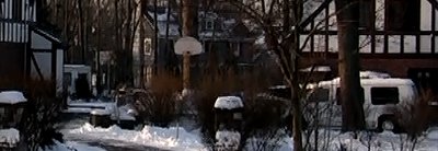

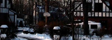

Brian,
I have owned several HDV camcorders and also a Canon HF100 AVCHD camcorder which I prefer to all of my prior HDV equipment in most respects.
Regarding resolution differences, the crux of the article and comparison you cited, I disagree with the author based on my own experience. I have attached two crops, one from my Canon HV20 and the other from my Canon HF100, of the same subject. The differences are not dramatic, and these are a small portion of much larger frames, so the overall detail differences will not jump out at you, but the very observable difference when viewing the two still and video images is a noticeable improvement in detail when going to AVCHD.
The author of the article failed to acknowledge that the 1920 pixel detail in the AVCHD frame is matched to the sensor's 1920 pixel count for AVCHD, whereas HDV is downsampled to a 1440 pixel width. The extra 480 pixels (which are 33% more than HDV) seen by both the HDV and AVCHD sensors but only stored in the AVCHD frame (but not in the HDV frame except as interpolations) do amount to something......
You need a fast quadcore and a good 1920 by 1080 monitor to adequately see and compare the 2 video clips, but I wil be glad to post or email them if they would help you make direct comparisons.
If your need is for wedding photography and low light, I would say that none of the current consumer AVCHD camcorders is really the right choice. The overall control and performance in audio, low light, and focus control is probably best served with a more professional model.
Larry
