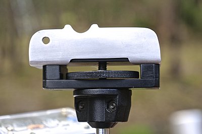

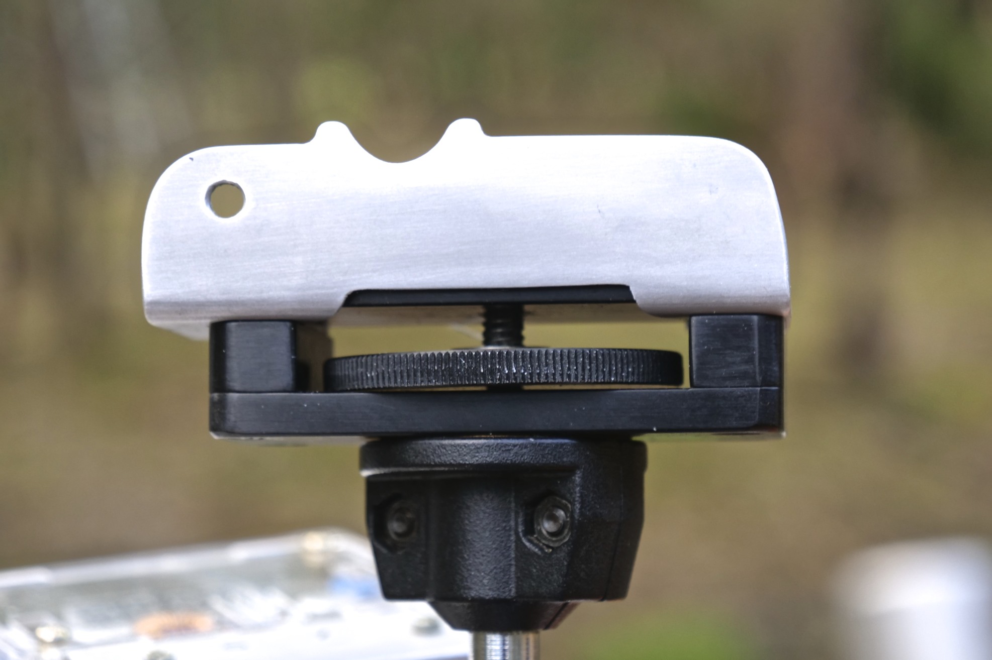

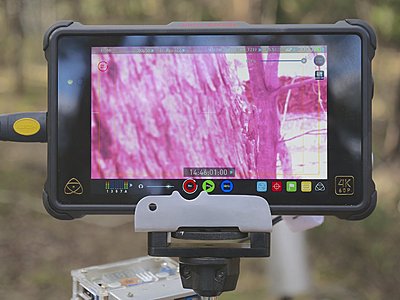

At the moment I am experimenting with a simple ‘finger guide’ with which I can hold my finger in place or quickly get my finger into place while I am watching my subject either ‘in the flesh’ or on the screen (photos below). I would prefer a switch on a lead but this is a useful start. It is made of aluminium and is attached to the ball head and sits about 8mm in front of the Inferno screen. I have modified the profile a number of times but this version has survived several recording sessions.http://www.dvinfo.net/forum/attachme...1&d=1527939487
