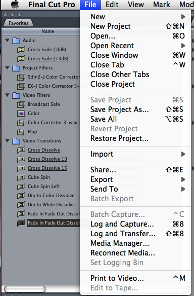

Old November 10th, 2011, 09:33 PM   #10
Location: Boca Raton, FL
Posts: 3,014
Re: long time Tape user converts ...... HELP!
Yes. Log and Transfer is the equivalent for solid state to Log and Capture for tape. It's under the File menu as shown in the attached.
long time Tape user converts ...... HELP!-screen-shot-2011-11-10-10.31.39-pm.png
Old November 13th, 2011, 10:52 AM   #11
Location: Marietta, GA
Posts: 32
Ouch....The Ninja uses standard 2.5 hard drives, Once I get back from a shoot I pop the drive into a reader that came with the recorder and it mounts on the desktop. I went into Log and Transfer and it did not recognise any media, and I can't figure out a way to point it to the mounted drive. Can you control what FCP sees?
Arthur Woodle is offline   Reply With Quote
