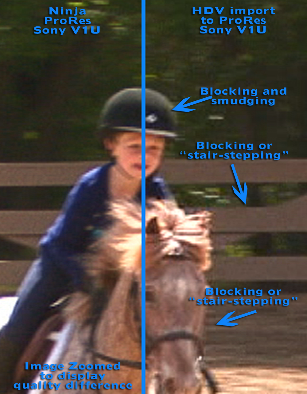

Okay, here is a still image taken from my Ninja-HDV compare video. I think this is probably the best way to demonstrate the differences that I mention above.
This is a still frame grab (TIFF) from my split video. The left side is Ninja footage captured in ProRes from my Sony V1U. The right side is HDV video, as captured onto tape. I then converted to ProRes during the import. Since this is my normal work flow, it was what I used to see if my perception of color correction differences, etc were actually real based on image definition and quality using my existing work flow. No color correction was done on the image. Pure Ninja/ProRes and HDV/ProRes stacked on the timeline.
I did zoom in, so that the differences were more obvious. This is an action shot, taken outdoors in good lighting conditions.
As you can see in the image, there is a big difference between the left hand side and right hand side. I did compress to jpg for posting here, but I don't think it changed the overall difference too much when comparing left to right. (be sure to click on the image to see a larger version)
As I have mentioned previously, I don't see a "major" difference when playing back the video at speed and normal size, although I do believe that the image is better. However, when taking the footage into Apple Color, I believe I see a major difference in the output and the quality. I imagine compositing/keying would also show a major difference as well based on the artifacting that can be seen. I also believe that my encodes look better when compressing for the web in h.264 or x.264.

Old June 6th, 2011, 04:43 PM   #26
Location: Saskatchewan
Posts: 3,048
Re: Atomos ninja 1080 50p
Jeff,
First, thank you for taking the time to put together this comparison!!
The real sign of the difference is the fence and the trees in the back ground!! They are significantyl better.
