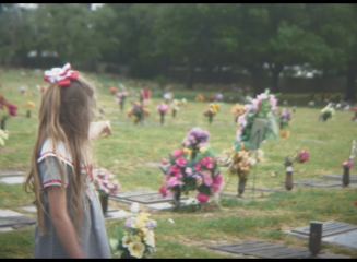

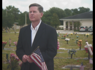

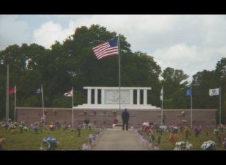

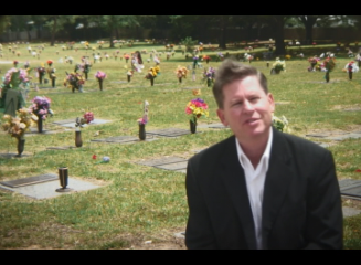

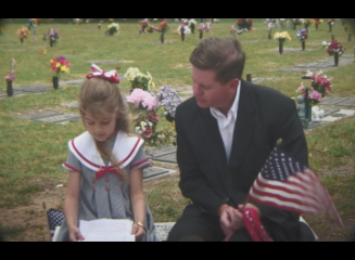

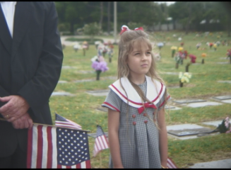

I've been obsessively reading the threads about DIY 35mm adapters for a while now. I took the plunge and built a very simple spinning (cd) disc model. Used 2 binocular ends mounted face to face for my macro lens. Added a 50mm prime on the other end, Focused it on the disc and shot a film today, (my first ever).
I've never shot a film before. I've been shooting and editing video weekly for about 9 months. This was a 4:38 minute short for Memorial Day Services at church. The audio suffered due to 20 knot winds. The lighting constantly changed due to scattered clouds...
But what worked perfectly, was my spinner. Why? Because of this forum and in particular the in-depth contributions and nearly constant information uploaded by Bob Hart. Others have recieved credit for pioneering different designs, but Bob has contributed a whole library of information on techniques, things that work, things that don't.

You are doing surprisingly well with binocular optics, no apparent vignette or hotspot, no apparent distortion - good work.

I wish I had photos of all of the staff as I described what I would be using for the shoot, and then when they saw me load the CD blank and put the lid on the box. It was a 4 minute short and the shoot was less than 3 hours. Because I don't yet have field monitor, I was the only one that could see the footage. You should have seen the skeptical looks riddled with concern the whole day.
But then, when those film images came onto the big screen in post. The detail of the little girl's hair blowing in the wind, against a beautifully out of focus background. Just breathtaking. No more skeptics.
The information you posted, along with others, ensured the success of my first build. Perfect no. Beautiful yes. Thanks again for sharing so much info for so long.

No flicker, no vignette that I could see. Maybe a slight hint of corner falloff which you may get if you are not using f1.8 lenses on an image size larger than 24mm wide.
