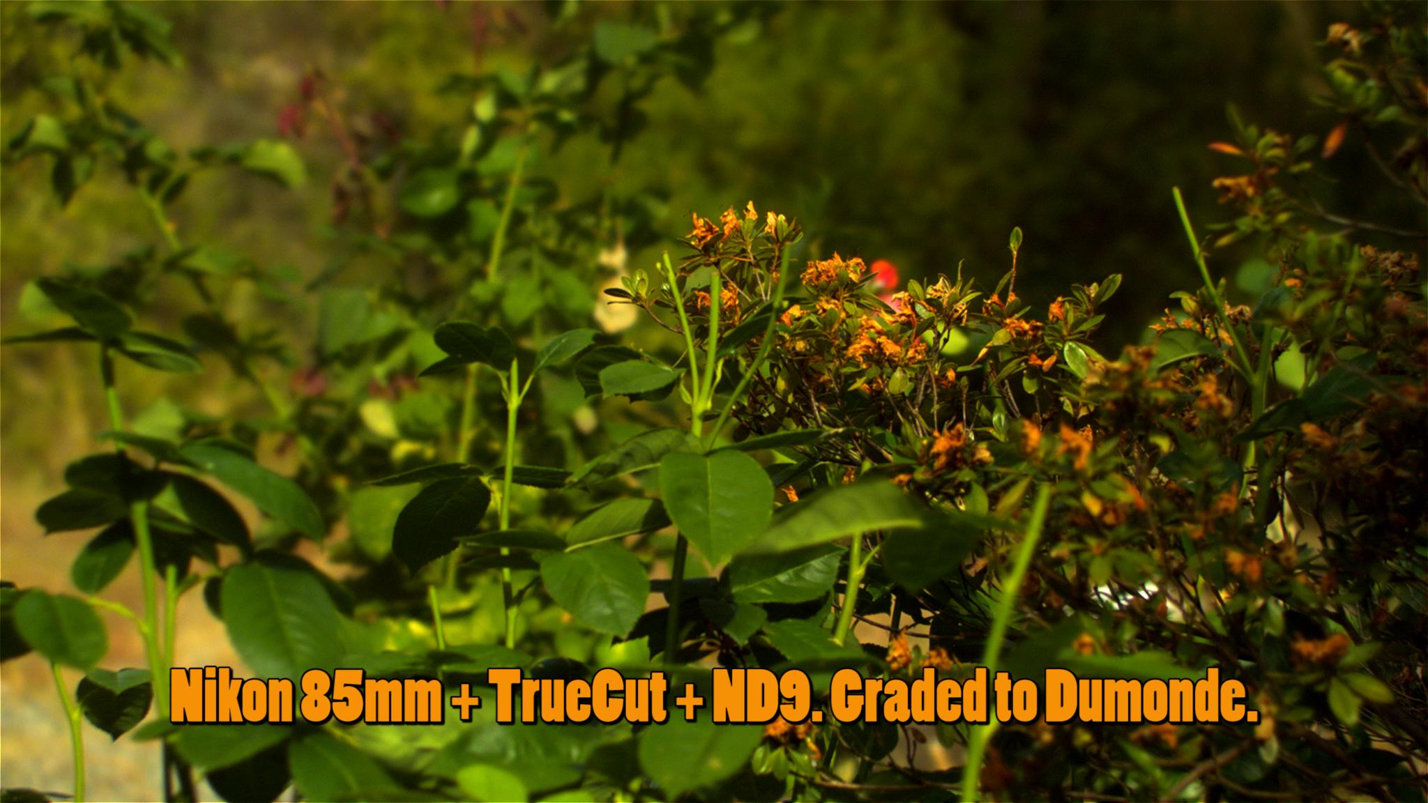

For sake of interest, this is a grab from the prototype Cinevate varifocal relay/Brevis/SI2K. I'm waiting for a CF1 diffuser before doing furthur tests.
