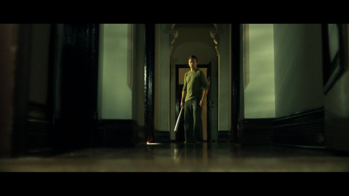

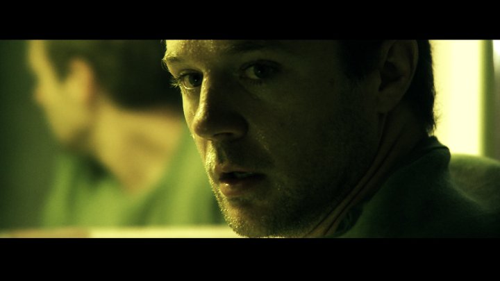

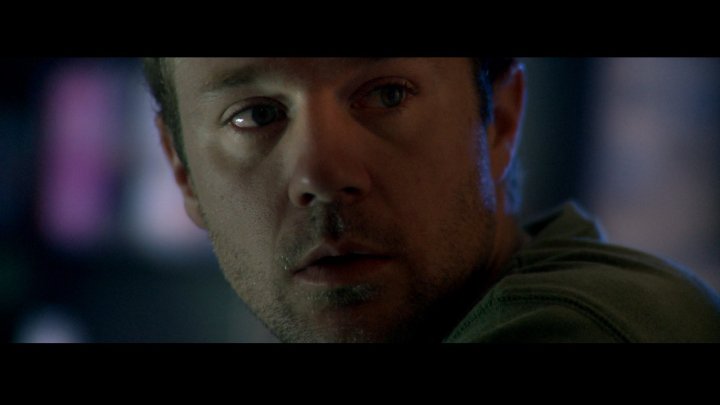

Here are a few framegrabs downloaded from the "Surfaced" facebook album, hopefully not too degraded in the process.
Numbering :-
1 2
3 4
1 - f2.8 14mm Sigma-for-Nikon.
2 - f1.4 85mm Nikon. ( I think, might have been f1.8 105mm.)
3 - f1.4 85mm Nikon. ( I think, might have been f1.8 105mm.)
4 - f1.4 35mm Nikon.
They attempted to stay as close as lighting permitted to the lenses' sweet spot and also took care to check and maintain relay focus with test charts, not eyeball rules and always after powerdowns and restarts. It is the only way to do it properly. The time there was a relay focus drift problem, the autofocus was found to have been switched on.
I picked the best of the facebook pics for here. There are one or two others which are a bit softer (autofocus drift).
