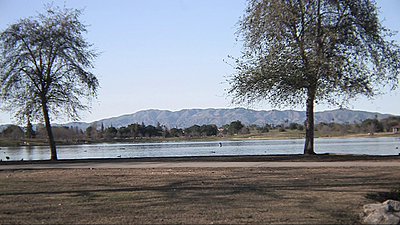

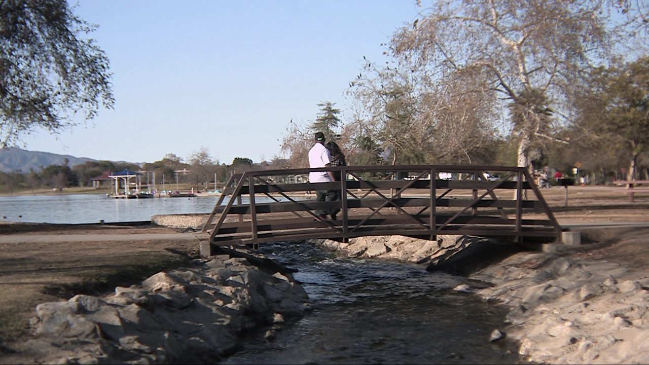

Here's some new XH-A1 / SGBlade footage using ROTOrazor 2. The first minute and 15 seconds are shot at f8, the rest at f4.
I really, really, like the look of RR2!
Nikkor 50mm f1.4 @ f8 & f4. Vision7 preset, no color grading.
SGBlade Test / XH-A1 w / ROTOrazor 2 By Marcel Van Someren On ExposureRoom
Here's a couple of screen grabs. f8 and f4. you can tell the difference by the DOF.
SGBlade w/XH-A1 footage-rr2_f8.jpg   SGBlade w/XH-A1 footage-rr2_f4.jpg

That looks great Marcel. Even at F8 there was a nice subtle DOF. It looks great to me. I heard a lot about not stopping down that far because you get to see the spinning glas. Or isn't that the case with the SGBlade?

Yes, even the shoot35 website says that with the RR2, f4 is the limit. I'm sure under some conditions, that's true. I am really pleased with the performance of the Blade and the image you can produce with it. I think that I'll only pull out RR1 if I absolutely have to because of low light conditions, need high shutterspeeds, or I need to stop down to like f11 or something. Otherwise, I'm sticking with RR2.

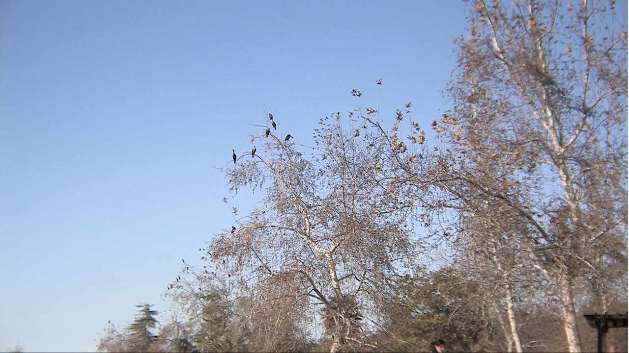

David, I think what you're seeing in the first few scenes is a combination of sensor noise (this is the A1 after all), compression and the 4X4 polarizing filter which, for some reason, sometimes causes the upper part of the sky to look dark, almost muddy. I'm sure I'm doing something wrong.
As Bob stated, grain would appear as a moving semi circular patter. There is none of that in any of the images that I can see.
From 3:00 to 3:42 in the video there are very large portions of open sky. I can't see one bit of grain.
SGBlade w/XH-A1 footage-sky1.jpg   SGBlade w/XH-A1 footage-sky2.jpg

This means your d.i.y.adapter will be r.i.p.? LOL, This is a good test to push the blade. Whats the lens and aperture Marcel? Of those last 3 frames you just posted.

I think the DIY will just become a reserve adapter. I don't regret building one, the knowledge gained is invaluable. Plus it was fun and functional.
The blade is more compact, better build quality than my DIY and has a flip module. I like the interchangable GG concept as well. Stopping down with ROTOrazor 1 is not an issue, but the bokeh isn't as nice. The ROTOrazor 2, which I used for this video, will be my main GG for most projects.
I actually had it at f11 at one point when I was setting up and didn't see any grain in the view finder. I thought I had hit the record button, but I didn't.
The entire video was shot with a Nikkor 50mm f1.4. Those last shots were at f4. Even the sunset scene was at f4. I just added ND filters. Only the first 1min & 15 sec was at f8.
