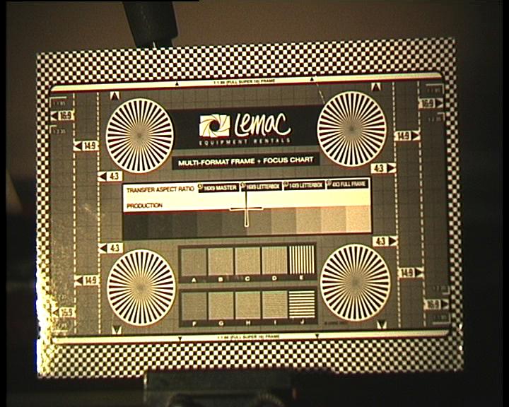

I have had a bit of a play experimenting with the genuine P+S Technik JVC GY-HD--- direct relay on back of a Letus Extreme to see if it is viable to shove the Extreme on front of a SI2K.
The 2/3" CMOS image area of the SI2K may be a little large for the 1/3" relay lens despite the larger screen area of the Letus groundglass. Until I have an underscanning monitor to study I won't know if this is workable. The P+S relay also has a small exit pupil which may not suit the 2/3" image area. Chances are there may be corner or edge softness and brightness falloff into the corners.
The JVC KY-F50 camera I am using is SD only so edge softness truths are not easily seen.
It seems however, that the Mini35 JVC relay which apparently also fits up to the Z7 may work on the back of the Letus in place of the Letus own achromatic dioptre. It seems it would have to be very closely coupled, more so than to the genuine Mini35.
P+S Technik set their relay up to be sharp on their groundglass at close to its equivalent of distant focus.
There might be a little wriggle room to go closer with the relay lens and use its focus adjustment to gain a little more of the available groundglass area the Letus screen offers. I have yet to try this with the genuine JVC camera however.
The real world decrees that there will be little extra more image area to be had from the Letus versus the Mini35 itself with the Mini35 relay to a 1/3" camera because this relay has been optimised for the genuine motion picture frame of about 24mm.
This reprises the same "multiplication factor" issue which was one of the complaints about the original Minolta based Letus direct relay for JVC GY-HD--- and Canon XL camera families. Whilst the frame size of that relay was close to faithful to the genuine movie frame as is the Mini35 itself, this area represents a small area of the Letus groundglass.
Please do not go out buying P+S relay lenses from on-line auctions on the strength of my comments as you may be disappointed if I am wrong, which is a distinct possibility.
Old August 10th, 2008, 09:25 AM   #13
Posts: 4,477
Postscript to my previous post.
Using the P+S 1/3" relay for the larger Letus screen to a 2/3" imager is a dead end. The 2/3" imager shows a significant portion of the groundglass carrier frame edge.
A Nikon 35mm f1.4 will yield coverage of the Letus groundglass screen to a 2/3" imager with the Letus achromat in place in the rear of the "Extreme". It appears though that there is too much resolution lost through the Nikon for this to be a workable option to relay the Letus Extreme to the SI2K.
I was not able to achieve even MiniDV resolution via this route as the attached image illustrates. A properly engineered solution will be the only way to go, no doubt what the Le brothers have discovered and acted upon.
The smaller image area laid within the 2/3" imager by the Mini35 relay appeared to be sharp to the SD camera I was aquiring the image with. Next opportunity which won't be soon I will put this on the front of a JVC GY-HD111 to see what happens. If it is good for the HD100 it should also be for the Z7.
