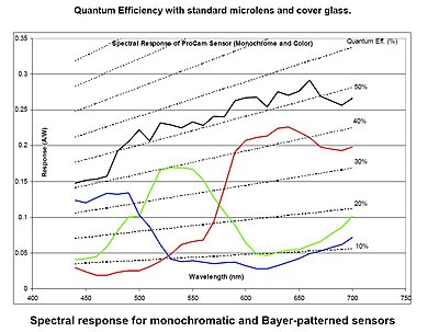

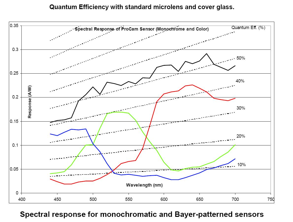

Old April 12th, 2008, 06:58 PM   #322
Location: California
Posts: 63
Originally Posted by Biel Bestue View Post
i do belive sumix color is just great, and the whole camera it's huge! don't get me wrong in that but, if pure white is not white but redish, that in luma speaking it's not pure white but lighter grey, so it's not a color problem but an intensety one, isn't this an issue? that would be like if the camara couldn't represent pure white! at least not correctly
Please see attachment the sensors spectral response. Red is quite stronger. Without color correction red dominates.
On the intensity issue, we have designed a better IR cut filter with half the thickness (1mm) and anti reflection quoting for blue green. This new filter with corresponding spacing rings will be shipped to our customers in about one month. Intensity must be improved by 20-30% on the high end of the spectrum.
