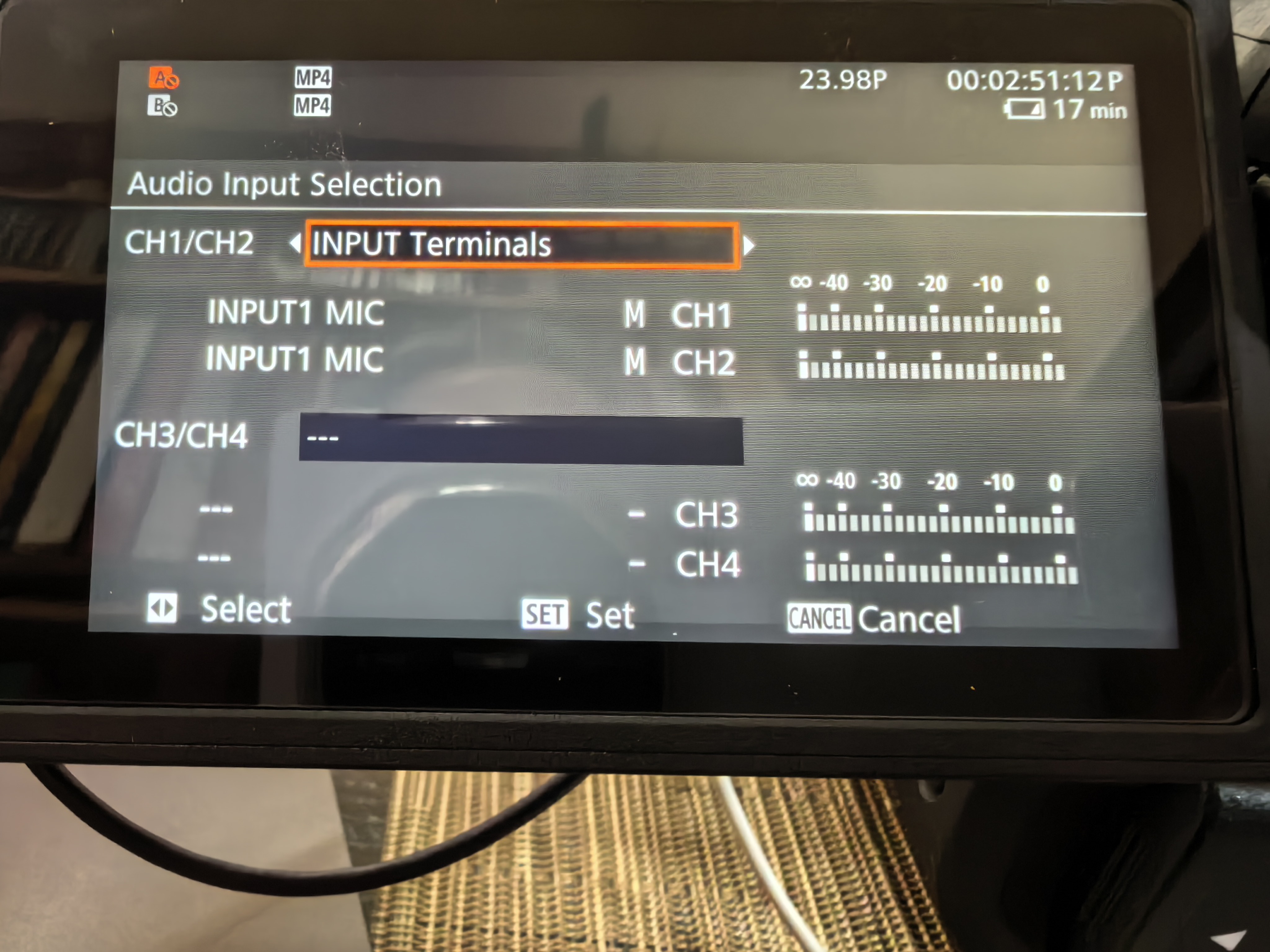

I know C70 has a noisy preamp but I don't know if my C70 has faulty preamp or this is a normal noise level. Can someone verify for me? I'm attaching a file.
Some info:
1. Firmware 1.1.3.1
2. No mic attached
3. vol level set to 5, Manual
4. audio input selection set to INPUT TERMINALS Input1 MIC+48 for both channels.
5. No fan running while recording
https://www.dropbox.com/scl/fi/rqhdt...11rkb9sj1&dl=0
