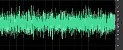

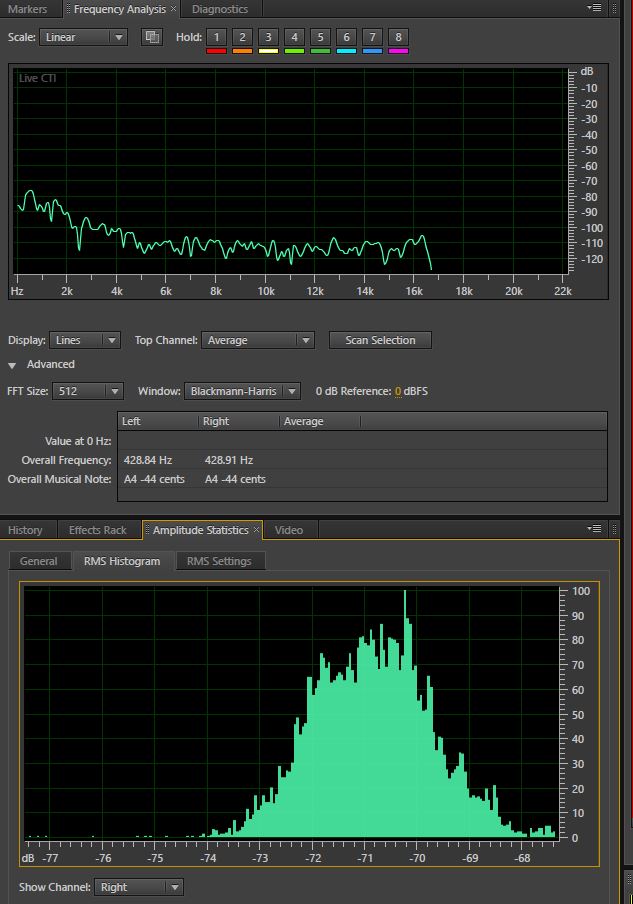

Re: What is this noise and how to remove it?
If the file I downloaded is an accurate measure of the sample, it seems to be a very low level base noise that probably could be ignored, as -70 dB is pretty small. This kind of noise can be from normal electronic noise in the recording devices, background rumble in the venue of the recording, etc. My home, with even with a small and absorbent room, with everything electrical turned off, has a constant -52dB rumble much like this. Again, if the levels in the sample are the levels you are worried about, I don't think they are much of a problem. You are correct, de-hum is for a specific frequency and its harmonics; this is a broad-range random noise from near 0 to around 17khz, and that won't help. You could do a sample and remove using a regular noise removal tool if you feel it's necessary. The capture shows what looks to me like a typical random noise pattern that is, to some extent, always present in a recording.
What is this noise and how to remove it?-analysis.jpg   What is this noise and how to remove it?-capture.jpg
Battle Vaughan is offline   Reply With Quote

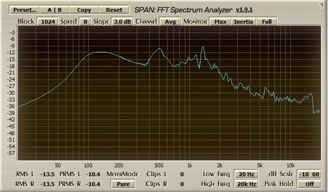

The noise is broadband so a hum remover tool and would not work well in this scenario. 'Hum' removal tools typically work @ 50 or 60Hz and the pertinent harmonics.
The source file's noise is around -60dBFS, which should be inaudible for most playback situations, unless cranking the monitor volume to abnormal high levels or normalizing just the noise with no other content. The audio on the frequency spectrum graph was normalized to show the frequencies clearly.

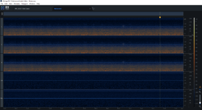

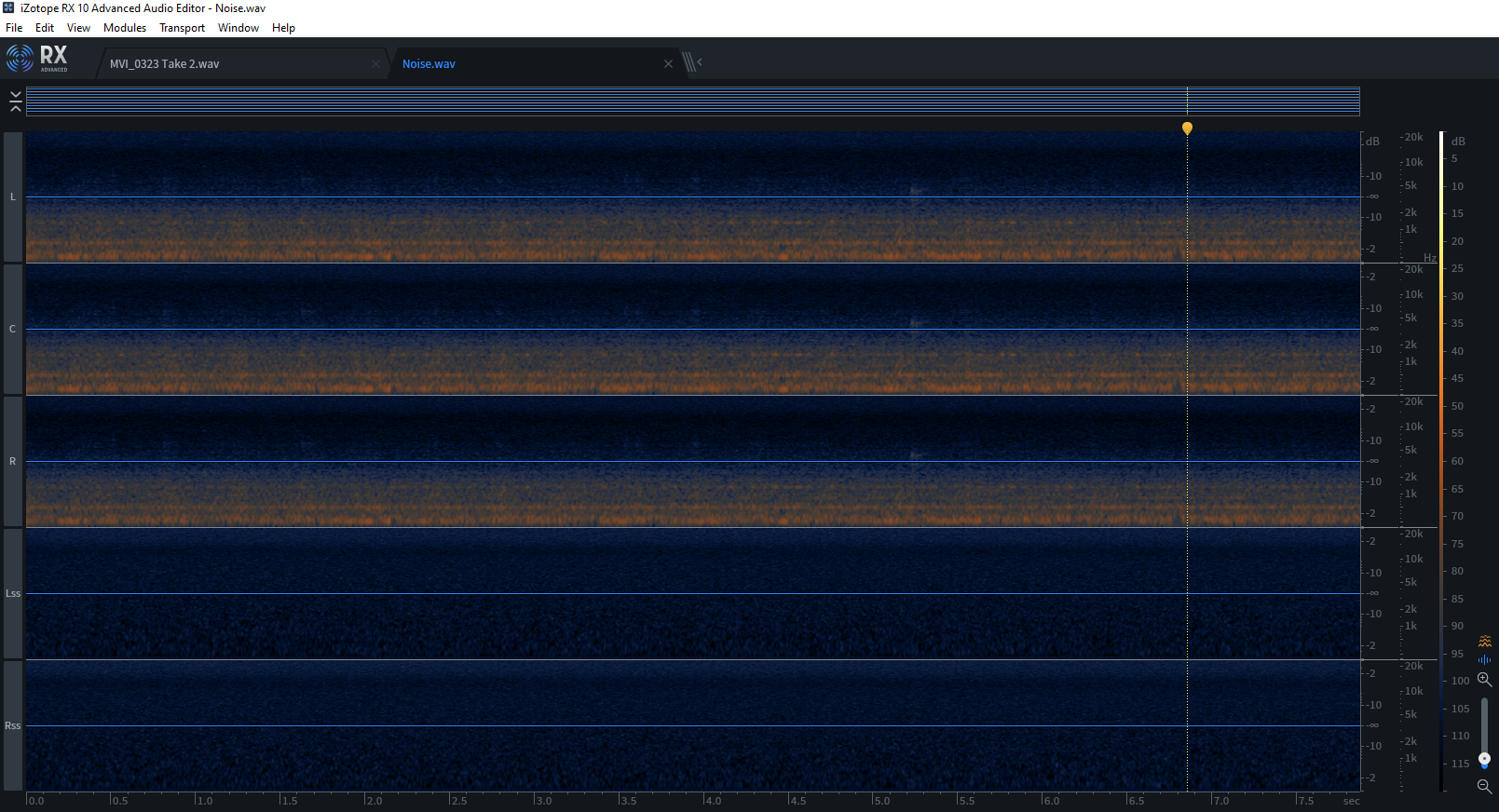

So many tracks. What am I looking at here? I've got it in iZoRX10 Advanced and I can't figure out what I should be focussing on. Please explain.
https://www.dvinfo.net/forum/attachm...1&d=1671605502
Last edited by Graham Bernard; December 21st, 2022 at 12:52 AM. Reason: Cant get PNG to upload!

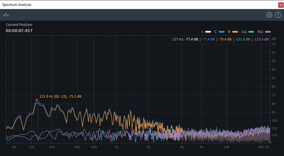

OK, RX Spec Analyser giving -75, not bad at all. And now I "see" the other streams. Just what they are from your capture, like to know. But, it all depends on just what it is you're attempting to hunt down. Are you purely wanting to ascertain just where these low dbs are coming from? Curiosity? Is it impinging on your Project? Are you wanting something less than -75? Are you searching for what could be making this type of noise?
https://www.dvinfo.net/forum/attachm...1&d=1671606161
Nice project, but I need more of your premise for just what you are searching for - please?

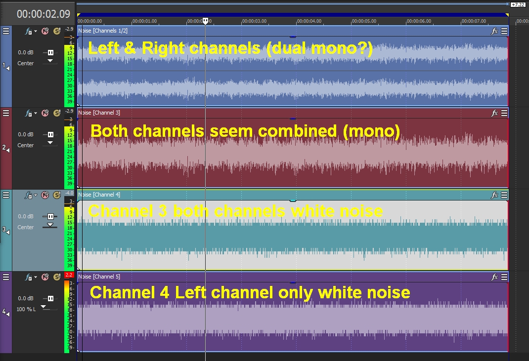

Posts: 1,606
Originally Posted by Kathy Smith View Post
I have this specific "hum" and I can't figure out how to remove it. I have IzotopeRX, and the de-hum module doesn't do much.
Whatever the noise is, it's a combination of things.
Track #1 has two channels, both left and right tracks, which appear to be dual mono and appear to be identical to each other.
Track #2 is showing on both channels, but appears to be summed mono.
Tracks 3 & 4 are purely White Noise. Track #3 showing on both left and right channels, and track #4 only on the left channel.
If I had the job of processing this "audio" I would totally lose tracks #3 and #4 as they are purely "noise". I would ditch Track #2 as it appears to be a summed mono version of what is on Track #1.
Finally, looking at Track #1's two channels, I could clean this up very quickly with Sound Soap, I think? Not having the associated audio with this 'noise' makes it hard to come to a definitive conclusion, but I have cleaned up this sort of noise quite successfully in the past.
Chris Young
