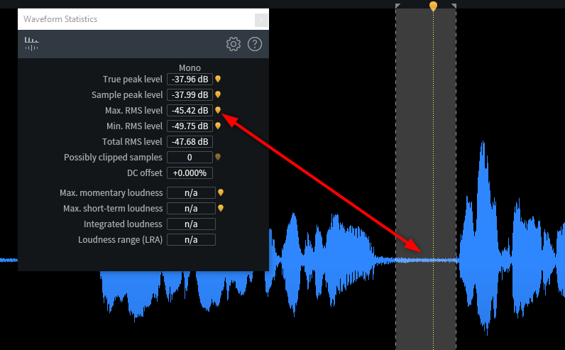

No worries from me, glad to see you back here and to have that snippet to analyze. I now understand the multi-track scenarios - it did throw me a bit. Now if my approach is incorrect and happy to be corrected.
My initial thoughts are that the low dB for the voice will kind of "mask" any noise floor that's there. I'd say that your MAX recorded VO is 50% of what you are presenting here:
https://www.dvinfo.net/forum/attachm...1&d=1672207190

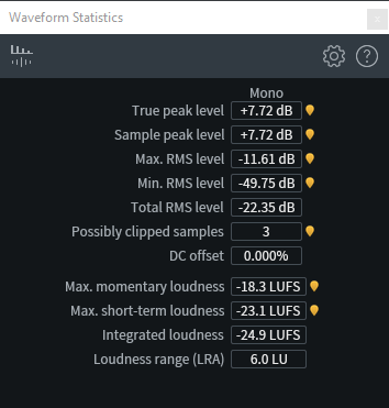

Once I GAINED your clip to -10dB I could clearly "hear" the noise floor. I don't think you've got enough to hear that rumbling noise with your cans. This is what I can achieve by adding +6dB GAIN:
https://www.dvinfo.net/forum/attachm...1&d=1672207932

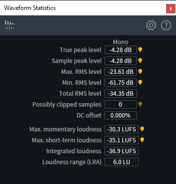

And now with adding a further +6dB GAIN - ie +12dB over the original:
And now clearly reveals rumbling at -45dB:
So, to recap, your sample does have some room noise rumbling, I've lived with less-than-perfect Audio - oh yes! But, if my attempts to analyze your sample has any useful response on your initial question, that you're looking for noise, then I would have to suggest it sounds like room noise. You're not hearing over your cans as a result of this masked by the initial low recording dB.

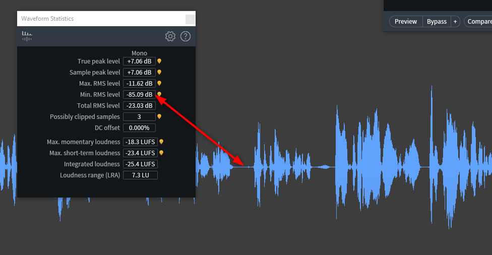

OK, I've now used Noise reduction on that rumbling. I've now got a cleaner Signal and a Noise floor of -85dB! I like this:
https://www.dvinfo.net/forum/attachm...1&d=1672209565

OK…. I’ve now listened and re listened comparing yours and mine. I’m more than convinced that the noise is coming from PC fans and being amplified by your room and surroundings. Reducing this by 50%, from -45dB to -85dB allows your Signal to win the day, and smother the noise floor. If I’m wrong about your PC fans then you’d have to look deeper and maybe consider removing any electrical forces impinging on your recording.
