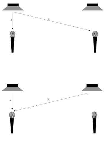

It's a specialty. Perhaps a specialist would be in order.
Don't rely on the line out of the ukulele, put a mic on it. You could record the pickup as well, but it's probably not the best sound.
Honestly, what you're doing with one mic on both might be the better way to go, but it does mean getting the placement and performance right.
Tracking the ukulele and voice separately can make the performance a little less authentic, but it does give more flexibility with production. You can place mics for optimum sound for each source. If you're going to track them at the same time as separate inputs, proximity and polar pattern will help isolate the two sources to their individual mics. If there's too much bleed you won't be able to control the balance effectively. The "3:1" rule of thumb is a good guide. The distance to the unwanted sound source should be at least 3x the distance to the wanted sound source.

I'd not record them at the same time - they'll fight because the uke is very close to her mouth.

One approach might be to stereo record it with separate track for the vocal and the uke. That solves the sync and possible overdub inexperience issues, and allows mix in post for the blend you are trying to achieve.
This is sort of the idea for acoustic recording of the uke although they are using a guitar. (I'm not endorsing the mic being used).
The 3:1 rule can be honored by close micing the vocal.

I think the concern people are having is how close the ukulele is to the singer's mouth. It could be hard to get good separation. I might be tempted to use a coincident stereo pair turned sideways. That would eliminate arrival time (phase) issues.

I'm never convinced by the 3:1 rule. It's very difficult to get that kind of separation without resorting to weirdly angled mics and then the singer moves a tiny bit and the instrument vanishes. Live, you have no choice, but with a small sized use - you'll never get it out of the vocal mic, especially bad with uses because their short sustain means people play them hard and they're very close to high male/low female voices.
Me - I'd record the use on it's own, then get the singer to sing to that, then mime the thing for the video.
