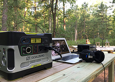

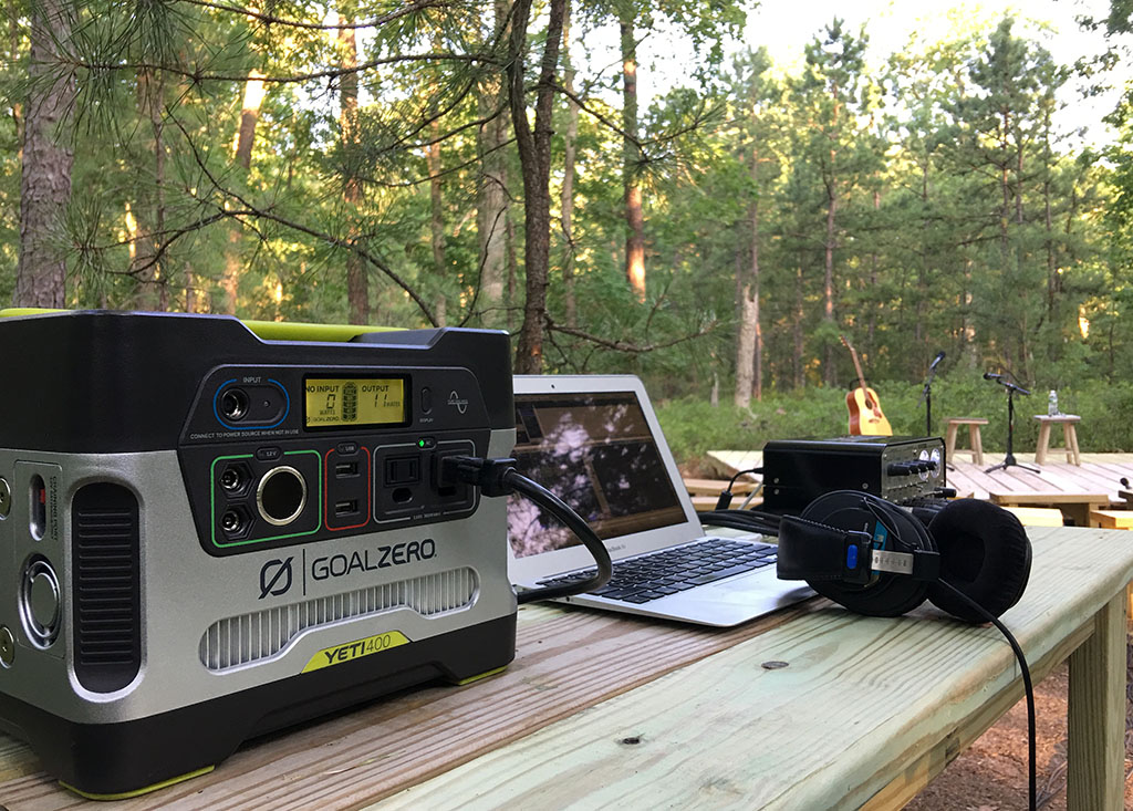

Sometimes techies can overthink problems and solutions. Was the power you wanted just a plain vanilla old 120 volt, 15 (or 20) amp wall outlet? FWIW: For modest camcorder power at long events I often carry about 100' of indoor/outdoor orange extension cord (#14 works well, on a spool), gaffers tape to hold it down, and a surge protected power strip.
If far from outlets, a typical 35 Ahr golf cart battery and a car power charger/adapter that works with your camcorder can give a lot of run time. Expect perhaps 15 hours run time with a 2-amp (14 watt) camcorder.
dpalomaki@dspalomaki.com
Old April 22nd, 2018, 11:30 AM   #30
Join Date: Dec 2002
Location: Mays Landing, NJ
Posts: 11,833
Re: I need some mic advice!
I have a Yeti 400 which would (theoretically) give you 20 hours run time with a 20 watt load. Haven't done much with it yet, but will use it for a family event soon in my micro-venue out in the woods.
The same company (Goal Zero) makes portable power supplies in a whole range of sizes. They can be daisy-chained and plugged into solar panels too.
https://www.goalzero.com/shop/power-...power-station/
