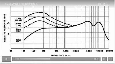

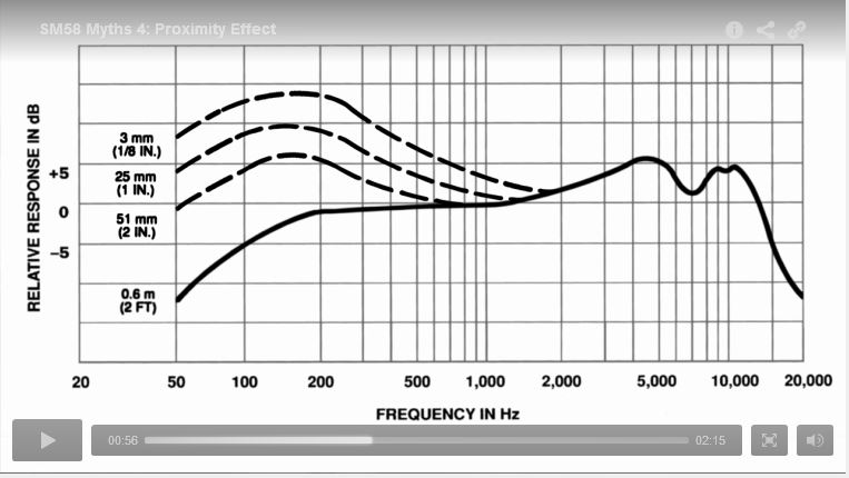

The proximity effect is a significant base boost for sources within inches of the mic and is common to all directional mics. It is often desirable for vocals. The overall frequency response pattern is fairly flat out to about 15KHz once the source is more than a foot or two from the mic (see the attached graphic from the Shure web site). The SM58 can be used as a PA mic as well, but the form factor is not optimized for that application.
