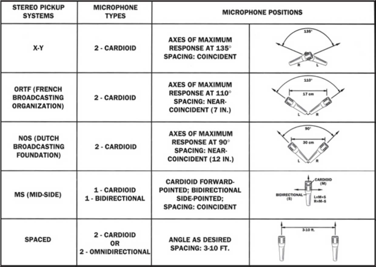

This is a VIDEO shoot as well as an AUDIO recording? How many cameras? What kinds of restrictions (if any?) on visible microphones or stands? What is the intended motivation/purpose/intent of this video recording?
The photo makes the space appear to be enormous, so it seems impractical to try to "fly" anything, either horizontally or vertically.
You don't appear to have ANY suitable microphones according to your list. How TALL is your "Master Light Stand"?
Reasoning: you could use a "single point" mic technique (ORTF, X-Y, M/S, etc.) and a single tall stand. But that stand would need to be essentially in the center, perhaps immediately in front of or behind the conductor. That is frequently a problem with good video angles where people think that a mic stand in the center of the frame is distracting, etc.
https://en.wikipedia.org/wiki/Microp...ereo_recording
Urgent Help: Advice Recording a Choir (16 Members) in a Cathedral 9 Second Echo-stereo_microphone_techniques_table.jpg

I wouldn't mind using a single point mic technique. Would you be able to recommend a microphone of sorts to complete a recording such as this? I'll research the technique as much as possible.
Alternatively, would you blow the budget in order to get three stands and three mics? I dislike this option... it's not really a great option for me, really. If I got a clamp, I could possibly use two microphones in the same positioning (behind the conductor) so that one runs as a back up?
Thanks again, Richard! The X Y setup looks like a good shout. I've looked at some cardioid microphones, and I'd certainly be willing to purchase two for this shoot, if you can recommend some in the $300-400 range.

An X/Y setup should be OK depending on the width and arc of the choir (parabolic again), if the room is dark, you might be able to place fairly close behind and above the conductor and get away with it, with minimal visual impact - otherwise lower and in front of her may work - experimentation and time are your friends here. "Room/ambient" can probably come from that Zoom - find a place a bit further back - walk the room and look for a "sweet spot" during the practice - there will be good "spots", bad spots, horrible spots, and likely a few really insanely great spots (I'm presuming from the photo that the cathedral was engineered for acoustical quality, as are many modern venues). Mix the ambient in in post - a good pair of cans in post may be as critical, or more than, the mics...
First you've got to capture it, but the mix is also going to be interesting - I'm guessing they will want a 5.1 mix... whether they even know what that is or not, you'll be after a "surround sound" mix in the final product to best show the talent, and you want to mix to make it sound like the viewer is IN that room with all the sonorous beauty of the echo/reverb! The joyous part is you have to have a fairly "dry" source from close in to the choir... and the ambient to mix to taste in post!

Oy. Audio, especially stereo, is considerably more difficult that video, including multi-camera video.
This particular space looks quite challenging. None of the "usual suspects" when it comes to reflections. If it behaves like some of the capital rotundas I've been in, it could just be a nightmare from a sound recording standpoint. I'd have to be there to know.
Since you are clearly in over your head and want some help, here's what I suggest. I'd just try to avoid any thoughts of stereo -- you aren't charging them much you say, so don't give them much. Go with mono sound. Much easier.
Then I'd gaff tape one of your lav mics (the COS-11D is an omni, just what you need) onto the baby pin on your light stand, point the capsule down, about 45 degrees relative to the riser, and raise it off the deck somewhere around 3.0 m (your Manfrotto stand maxes out around 3.6m, so somewhat less than full extension should get you there). Position it so that it's at the focal point of the curve that the group makes (gather around the mic boys and girls), or a little closer in (so that all the voices are more or less equal-distant from the mic). The mic should now be pointing about midway between the two lines of singers, but it's an omni so the exact orientation isn't really all that critical.
Then, record the rehearsal, just like you would record a groom (peaks around -12dBfs, yes?) Every time they take a break, you listen to what you just recorded (use your headphones) and decide how to adjust your setup. How? What you're listening for is:
1) Does the group give you a balanced sound, and can you hear all the various voices. In particular, can you hear the basses and the sopranos without one being a lot louder than the other? The cure for this is often rearranging the group to put the weakest sounding members closer to the mic. But the conductor usually takes care of this kind of balancing. This shouldn't really be a problem for you, but you have to check it anyway because you're the guy doing the recording.
2) Do you hear a good balance between the direct sound of the singers and the reflections from the room? This is classic signal-to-noise ratio. If you get too much noise (room) then you need to get closer to your signal. So lower the mic, or push it into the group a little more, etc. You may well find that you want the mic lower, like maybe just 2.0 m -- just to control the long reverb tail you say this room has. If you're going to make a mistake here, make it in favor of a dryer (less reverb) sound. Better to be too close than too far away, especially in this building.
There ya go. That's it. Keep it simple. Really simple. One mic. One stand. One mic position.
And yes I'm well aware that the mic stand will be in your shot. But there's only the one stand, and it's tall and very thin. And... it's the only choice you have given the time available and the equipment available. So put it up where you need it without asking, and if anyone complains tell them (in the nicest most diplomatic way of course) that it's either this or sucky audio (which has the amazing advantage of being the truth).
Then, shoot around the stand. This is one reason to keep the mic above their heads -- it keeps the mic out of frame for your video, and that's a good thing for the video.
Finally, you may have to apply a little post processing to the audio. The COS-11D has a significant high frequency rise because it's designed to be used under clothing. So you may need to apply a little of the opposite curve via a parametric EQ if the high end sounds too bright or harsh. Small price to pay for avoiding the purchase of a mic that's more appropriate for this duty, yes?
There ya go. Good luck with it, and have fun.
