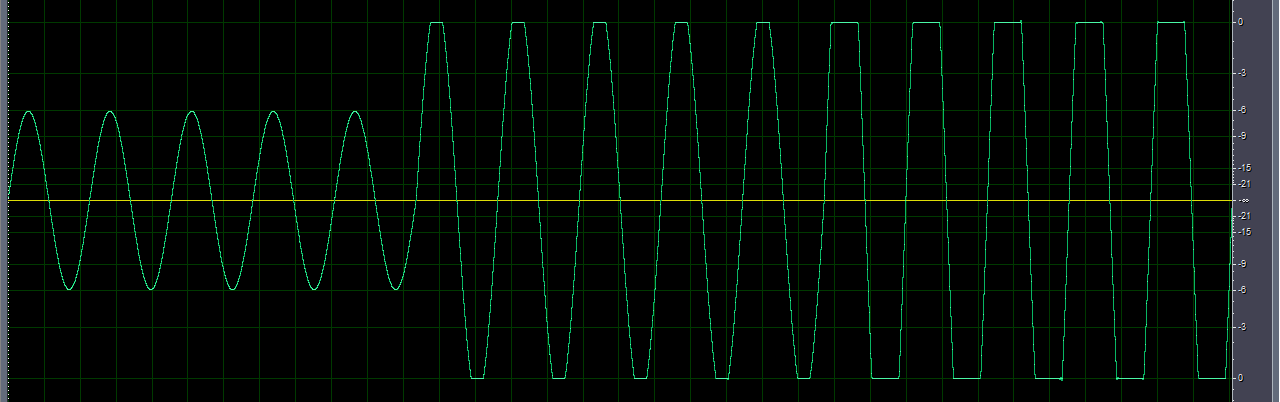

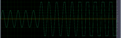

"Clipping" is when the level of the combined track exceeds 100% (which is equivalent to 0dB full scale or "0dBFS"). In the digital world nothing can actually exceed 100%. In practice, I (and many other folks) try to avoid any levels higher than -1dBFS ... EVER ... even on a final CD mix. (This avoids potential problems with overshoot in D>A converters and subsequent filter stages.) So if you see levels hitting 0dBFS that almost surely indicates there was some sort of problem.
A clipped waveform will have a flat top. This is easier to see with pure tones than with mixed "noisy" sounds like your track. Look at the attached .gif file. Here I started with a pure sine wave of 440Hz at -6dBFS. The first five cycles are unchanged. The next five cycles had the gain boosted by +7dB; you'll see that the waveform is no longer sinusoidal, it is clilpped or "flat-topped" at 0dBFS. The third five cycles had the gain boosted by +12dB; you'll see that the waveform is distorted further from the original sinusoidal shape.
Clipping produces distortion when played back. The worse the clipping, the worse the distortion. Play the attached audio file. I started with 5 seconds of pure 440Hz sine wave at a level of -6dBFS. That's followed by one second of silence, then another 5 seconds of tone, another second of silence, and a final 5 seconds of tone. All the tones were originally -6dBFS. But I raised the gain of the second tone by +7dB, so it is trying to reach a level of +1dB; however, it's impossible to have a level higher than zero, so this is slightly clipped. I raised the gain of the third tone by +12dB, so it is trying to reach a level of +6dB; however, it's impossible to have a level higher than zero, so this is more severely clipped. Listen to the difference in the character of the three tones. You will hear the increased distortion.
In the loud parts of your storm mix, your waveform frequently hits 0dBFS and is clearly flat-topped, so your levels exceeded 0dB when you were creating the mix. You should NEVER do that! When you remix this, keep an eye on levels. If you see anything hitting zero, stop and fix the problem.
