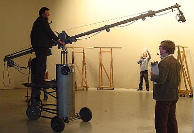

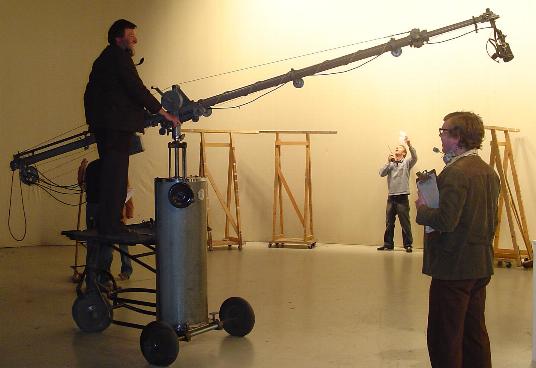

How many broadcast interviews on TV use booms? Actually, the formal ones (60 Minutes, et.al.) probably most of them.
OTOH, how many broadcast TV reporters (or news-readers) use boom mics? None of them. Or how many chat shows (or late-night variety shows, etc.) use booms? It was back in the era of Johnny Carson that they still used those big Mole-Richardson microphone booms on their own little trolley.
