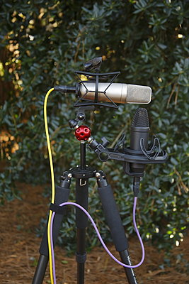

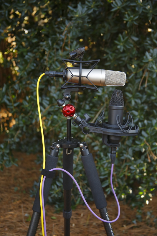

A small tripod would work. This is my remote setup for M-S recording with the wind protection removed. The little Manfrotto adapter is real handy. The mics are Rode NT1 and NT2A.
