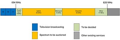

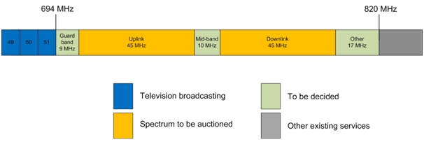

Don't throw away the old kit yet as there is some discussion going on that we 'may' be allowed to use the guard bands. There are three of these at the beginning, middle and end of the two transmit and receive 45 MHz blocks that have been auctioned for Telco reallocation. Lord only knows when they will make a decision on it though. These bands would be ideal as there is going to be no transmissions in them at all. With our puny little wireless mics, 10 ~ 50 milliwatt output we are hardly a threat to major communication interference in these clear spaces. See pix

That could also be a neat option and nicely within the range of most mics. Yeah at 10mw output we certainly would not disrupt and major communication networks but our issue I guess if the telcos buy the blocks as marked and you happen to be close to the edge where the guard band begins you will get a bright and breezy call loud and clear from a mobile phone on your receiver. Have they specified the frequency range of the guard bands yet ... that certainly would be a practical solution ... I think my one wireless pair is currently around 810mhz so it could already be in the guard band.

The three guard bands are 694-703 MHz, 748-758 MHz and 803-820 MHz.
Jands have a pretty good chart outlining which of their Shure mics fit the bill after Jan 1 2015.
http://www.jands.com.au/__data/asset...ency_Guide.pdf
If you look at the greyed out area to the right of the Shure chart you will see the frequencies that have been lost printed across the top. The three guard bands are in amongst these and are 9 MHz, 10 MHz and 17 MHz wide respectively. All good fun!

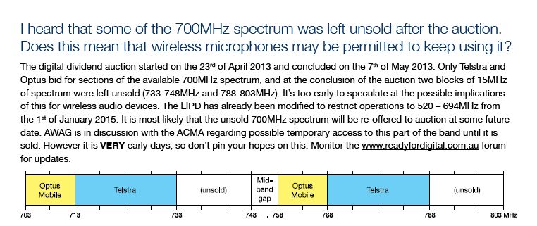

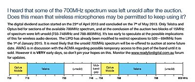

Not all of the spectrum has been sold.........
Brian P. Reynolds is offline   Reply With Quote

Yes that is correct. The government were hoping to make a fortune on the spectrum sale like they did in the earlier 3G auctions. The Telcos went mad back then then realised they had paid too much and were struggling to recoup the money spent. This time around they were a bit more conservative. We may be lucky but as I said lord knows when any decisions will be made.
