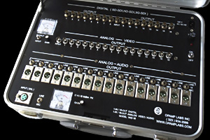

Are YOU actually responsible for providing the primary audio gear?
Or are you just one of many "press" coming to cover the event arranged by others?
Proper news conferences (and the like) frequently have "press boxes" which distribute pre-mixed mic-level signals so you can just plug it in directly to your camera. Some even provide "pool" video feeds as well.

Just to up date, I was able to take a feed from the press box, which I normally do.
This was a low key gig to start with and then the event organisers decided to get a pro audio guy to come in and handle sound, I'm so glad that they did.
