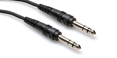

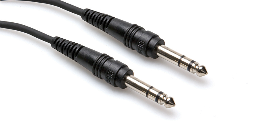

By "TRS" I mean a 1/4 inch balanced (Tip-Ring-Sleeve) plug. See the photo below....
As Mr. Miller said. You have enormously complicated your situation with all that gear. Even with decades of experience, I would NOT start by using all that gear. I would plug the microphone directly into the mixer and get that part working before adding ANY other processing or outboard gadgets.
It may make some slight difference whether you use the SX3040 processor before or after the MDX4600 Exp/Lim. But you will have try it for yourself to make the final decision.You may find that you don't need either of them. (or the MIC2200 either).
