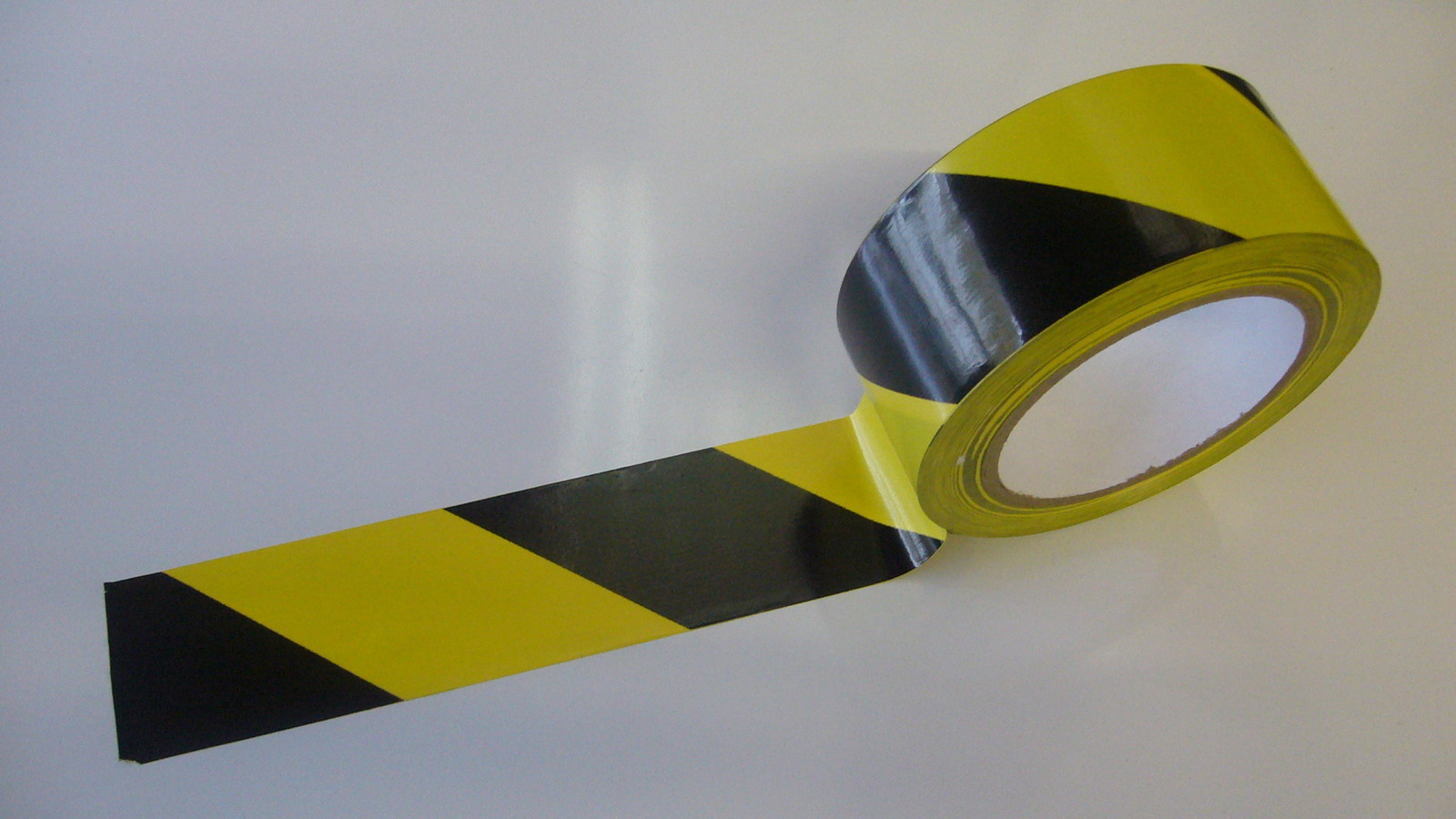

Noted, although cost plays a big factor here. Im only low budget. Extension cables sounds like a good idea although for this particular event im filming space is extremely limited and I think im going to be extremely close to/in the crowd so having an extension wire running across the floor isnt a possibility (in this instance).

Which would you prefer to do, figure out how to safely run a cable across the floor through the crowd or risk getting lousy sound so the entire shoot is a waste of time?

Old September 22nd, 2012, 01:58 PM   #10
Join Date: Dec 2007
Location: Glasgow, Scotland
Posts: 1,546
Re: Rode Videomic - Live Band - Settings
You need some of this:
(I wish I had bought shares years ago in the company that makes this stuff).
