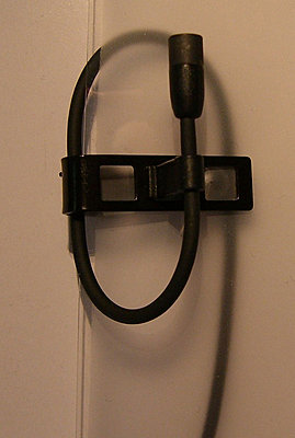

Here's a web picture of the loop... since the cable is secured on the right in the clip or jaw, the loop on the left can't absorb tugs.
http://www.dvinfo.net/forum/attachme...ic-fitting.jpg
It's not supposed to. Because the cable is secured to the clip (on the right side of your picture) vibrations traveling up the cable are damped at the clip and don't continue into the mic capsule. If the cable came straight off the capsule without being constrained, vibrations traveling up the cable would be transmitted directly to the capsule and to the mic's diaphragm

I think the problem is that we're actually discussing two separate things here.
Vibration damping
and
Strain relief.
Each is a separate issue.
Good mic technique like this addresses BOTH but if you're rigging a wired mic for a walking talent where someone might step on the cable, then a little loop like this isn't going to be much good. Conversely, if the issue is someone simply twisting their upper body for a moment, it's PERFECTLY useful.
And if the talent is in a fixed position chair, there's no vibration present anywhere along the the wire, then the loop isn't really required for vibration damping.
BUT...
The real issue is that these things pop up when you least expect them, so it's just smart and safe to learn to rig things properly as a matter of constant practice - even when there's no obvious need to do so. That way, if the problem conditions DO show up, you already have a practice in place that solves it before you ever notice it's even there!
THAT is the sweet spot.

Bill as usual you bring a useful new angle to the discussion: Strain relief. I think that the loops in the picture I posted or the strain relief loops tied with thread below the shirt might very well be useful for strain relief. If there's a strain from someone twisting their torso the pictured "broadcast loop" might very well save the clip from getting pulled (as the wire pulls out of the jaws of the clip), saving a sound guy from needing to straighten the microphone clip so it looks good on camera. Or if the microphone is hidden, strain relief loop(s) could keep it from getting pulled out of its ideal suspended-not-touching-anything position.
What I discovered in my tests however, is that while those loops are relieving strain, they are simultaneously transmitting vibration as the cable is being let out and rubbing against the clip or looped cable. So one has to make a judgement call about whether strain relief or vibration damping is more important in a particular application. Since I've had much more vibration/rustling issues than issues with mics needing to be repositioned, I prioritize vibration damping over strain relief.
Personally my approach is to avoid the loops and instead rely on slack in the cable under the shirt.
YMMV and I'm not trying to say that professionals who have been doing this longer than me are wrong for using strain relief loops if that works for them.
