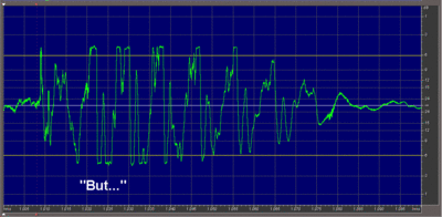

What I particularly notice is gain pumping. This was undoubtedly recorded with AGC at some point in the chain... presumably at the final recorder.
I hear two specific problems from the AGC. Listen to the distortion at the beginning of the word, "but." That's because the AGC had pulled the gain up prior to that word (presumably there was a long pause in the speaking, although you've made the sample too short to hear the pause). I would guess that the beginning of many of the minister's phrases (when they follow long pauses) are clipped like this.
The second problem from the AGC is that the background noise -- from the room, from the minister's breathing, and from the wireless interference -- is pulled up and made much louder than it really was. AGC will always exacerbate any problems with noise floor. Listen to all the shuffling, minister's breathing, minister's lip smacks, etc... all that garbage should be, at a guess, perhaps 10dB lower. The AGC is pulling up the level of all the noise.
So my advice for future events is: make sure all AGC in the recording chain is turned off. It will make your track sound a lot cleaner in general (including reducing any noise from the wireless system).
Unfortunately, without knowing the slope and attack time of the AGC, it will be very difficult to accurately correct for this in post. If I were in your shoes, I would try to play around with a bit of downward expansion, to see if I could get a more natural sounding track. (You could adjust gains manually, but that would be painfully tedious.)

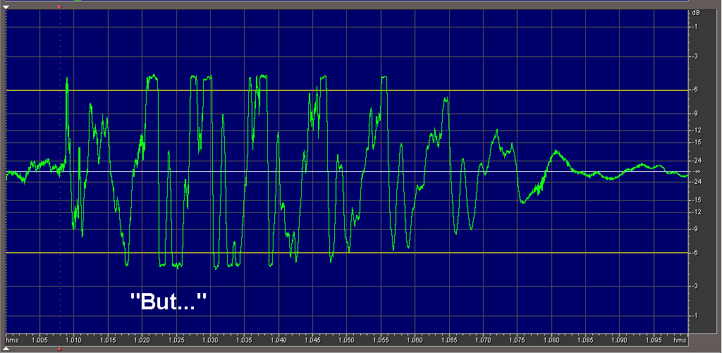

Here's a sample of your file, but with the gain corrected "by ear" to undo the effects of the AGC in the recording.
You'll note that the background noise (wireless noise, crowd noise, breathing noises) is much less objectionable than in your original file.
The sample was much too short to even attempt setting up any downward expansion, to make this repair automatically. I suspect it would be not trivial to do that, but if you could do that successfully, it would be less time-consuming than repairing the entire file's gain by hand.
You'll also note that the beginning of the word "but" is still clipped. In fact you can see the clipping if you look at the waveform. (But note that the level of the flat-topped waves is about -4dB FS. So either the clipping occured ahead of the recorder, or the file you posted online has had its gain changed relative to the original file from the recorder.)
