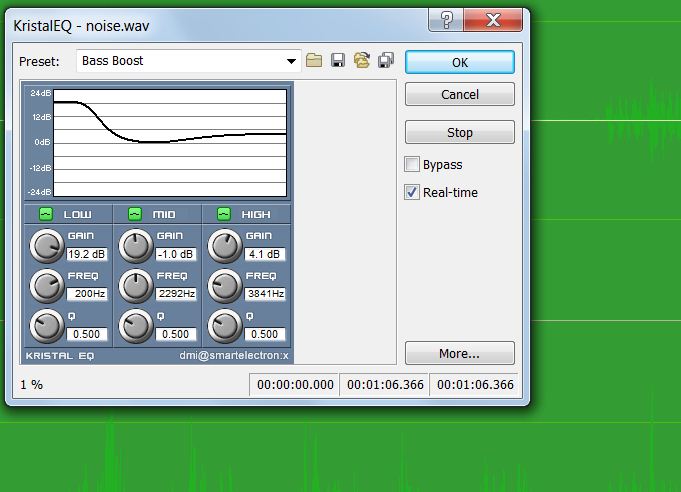

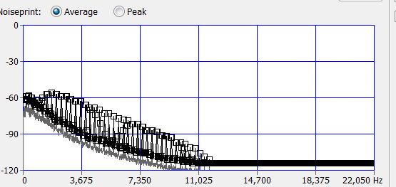

Here's a try. Problem is (see noise chart) that the noise occurs over the very frequencies that the voices occupy. The noise is fairly easy to remove (noise reduction tool in Sony Sound Forge) but it also removes a lot of the voice content. What I did, and this is quick-and-dirty, so I'm sure it could be tweaked better: add 10 db the original file to get the levels up to where you can work with them. Apply 25 dB noise reduction, sampling from an area that has the buzz only. Apply equalization to try to boost the voice frequencies to bring back some clarity. Best wishes!
