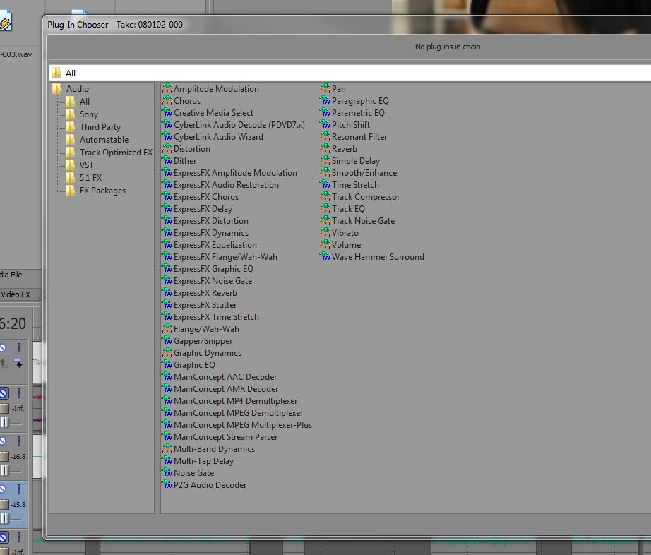

Well we shot the footage in a convention so the background noise is constant. Take a look at the screenshot attached, it shows a list of all plugins available with my version of Vegas, which is 10a.
Greg: I fully get what you are saying but I am only looking for a way to slightly adjust the sound with the minimum of effort. If it can be done then fine and if not I will just leave it as is.

Still, there is no magic "quality" knob to grab and turn up.
In general, there are 3 classes of audio tools to consider:
EQ - this is the most basic, and often overlooked tool. Roll off the low end until the desired audio is affected, then back it off a little bit.
Dynamics - this includes volume tools and compression/expansion tools. I see Wave Hammer in the plugins list. It's a pretty good compressor. Compress to keep voices natural, but more intelligible, but watch out for the tendency of a compressor to bring up background noise. Clean recordings can be compressed more without objectionable background noise "pumping".
Noise reduction - the most basic is a noise gate, that tends to lower the volume when overall signal is below a certain threshold. Usually overlooked in video work, because it's only occasionally useful. Noise Reduction doesn't appear in your plugins list, but it can be pretty magic in its ability to reduce many unwanted noise sources, but not all.
If you've decided NR is needed, but you don't have such a plugin, Audacity (sourceforge.net) is an open source audio tool that includes a basic NR.
That's a basic orientation to the tools, but, to repeat what's been written above, none of us have heard your sound, so we can't make meaningful recommendations. Don't know whether you need a saw or a scalpel..
