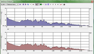

I listened on some HPs; AKG-240 ,Sony 7506 and Fostex T-20s and still don't hear any significant high-end hiss. But since my 50+yr. ears don't function like they use to, I checked this on a frequency analysis app. I only see a slight/narrow bump around 19kHz. (unlikely to be what your hearing.) I selected only the room-tone since that's where one would notice hiss and BG noise the most. Are you sure you're not hearing natural acoustical borne ambiance?
Could your sound-card or other playback electronics/amplification be the cause?
FWIW, In my opinion, Bose speakers are normally not good reference monitors..Far from flat, with hyped highs and lows. The AKG-240m HPs should be pretty accurate though. I'll post the frequency analysis image later on.

PT-test.wav, room tone around 00:00:06:25

Rick, perhaps the problem is with my listening gear. The hiss is definitely there, but you are right that it is more apparent with the Bose system. It is not nearly as bad on my AKG's. That said, most people that will end up watching my film back will either watch it on their computer speakers, of which many people do have speakers that kick up the highs and lows. I guess you could go crazy though trying to make sure your product sounds good on every available type of speaker.
