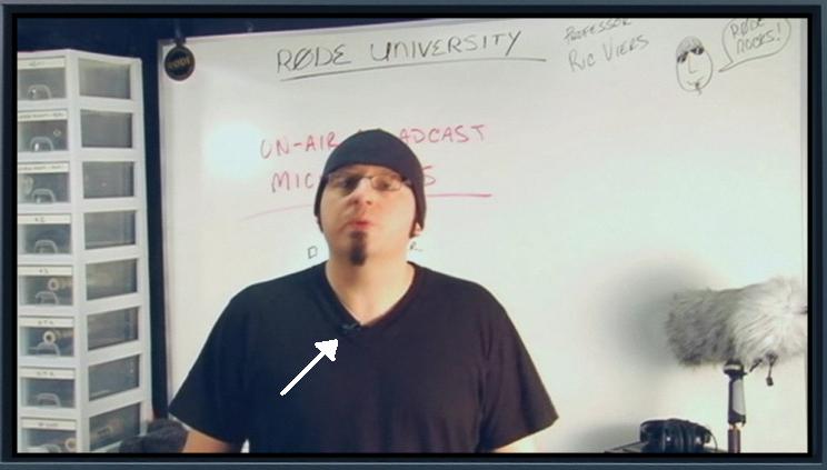

Okay, Rode did a great job selling me on how good one of their mics is, but they neglected to tell me which one! In the ENG segments, the speaker (Rick Viers?) is in a room with dry erase boards and a shotgun above him on a boom stand. The room does not look treated and has hard surfaces like the dry erase board. The sound is quite good to my tastes. I like audio to sound natural with an appropriate amount of room tone and little proximity effect but I don't like distant and hollow. This mic seemed to fit my purposes. They show off a bunch of other mics, but fail to tell which shotgun mic sounds so good indoors as this one. I assume it is the NTG-3, but they don't seem to say for sure. Of course, it isn't perfect in a noisy interior like the kitchen they shot, but in a semi-controlled environment it sounded fine to me. I like the idea of a mic that can fulfill maybe 1.75 scenarios instead of being only good for one thing and lousy for others.

Having seen what I believe is the video you are referring to I don't have any confidence that the shotgun in the video is in fact the capture device... I'm 100% sure that's a black lavalier microphone on the collar of his black T-shirt and from what I can tell it doesn't look like the Rode lavalier that I'm familiar with.
The NTG3 is the only Rode shotgun that is supposed to be any good, and personally I'd rather pop for a Sennheiser. Of course if any one is feeling generous I wouldn't turn down a Sanken.

Mark, I can't believe I let myself get fooled! I was so distracted by them constantly cutting away to show him being boomed for the shot that I didn't look for the lav. I should have known better. I'm glad I asked this question as I learned much more than I thought I would. Thanks for going through the extra effort to provide an answer. I think I share your opinion of those videos. Maybe if I wasn't a member of this forum and didn't already know the basics via osmosis just being around here, the videos would be helpful. As it is, they do get across an important point that not all mics can do all the jobs and a shotgun mic isn't necessarily good for indoor work due to reflections. I already knew this so the videos were redundant. The NTG-3 does sound decent and with my limited budget I would be a potential customer. Knowing what I know now, I'm getting a Countryman B6!

Actually, it wasn't any one video. In all the videos they seem to have a work/gear room they use as a sort of classroom set. In that room, they picture the speaker standing under a shotgun mic that looks like the NTG-3 but apparently that is not the mic in actual use. That is probably why they didn't mention which mic was being used to record the speaker indoors except in the NT5 segment in a racquetball court. Being a company that sells studio large diaphragm and pencil ENG mics, they didn't focus on the most important aspect of recording which is mic placement. They don't sell lavs much and didn't go into all the scenarios that are best for them.
