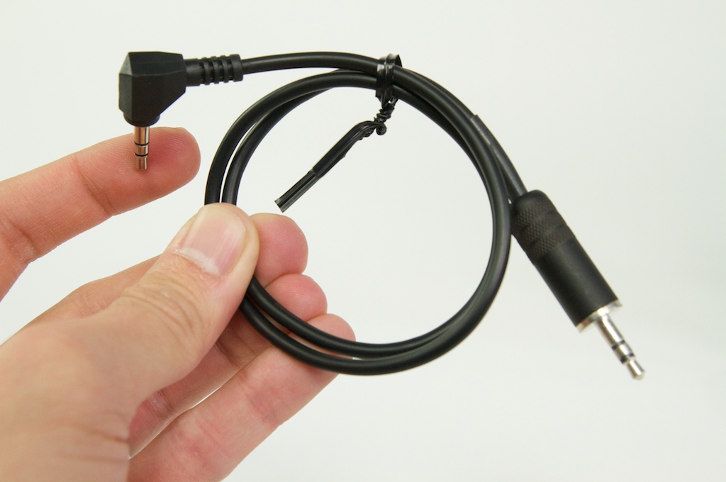

It's an 1/8" mini to mini with a resistor built-in to bring the level down from line level to mic level. I use it with the Tascam (when it working lol) and with Zoom H4n.
DVcreators Line to Mic Cable at DVcreators.net
