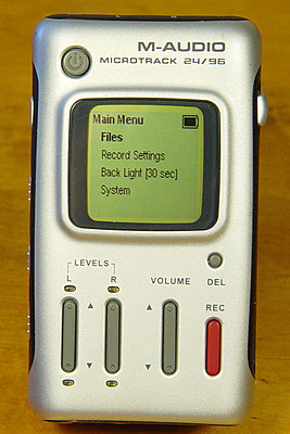

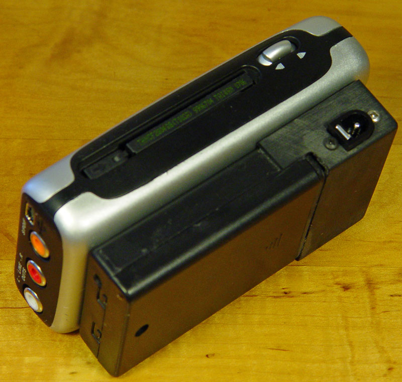

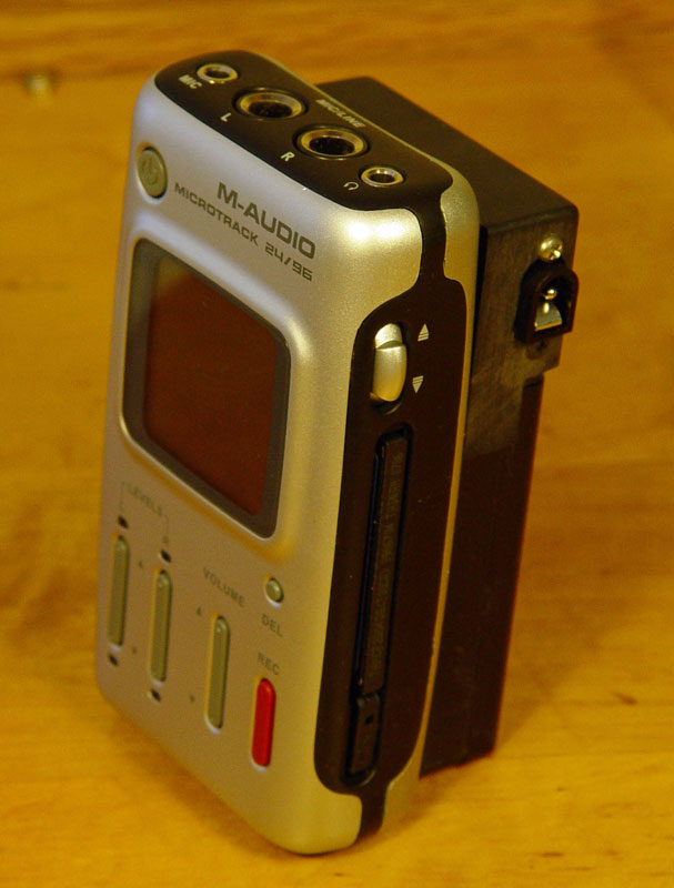

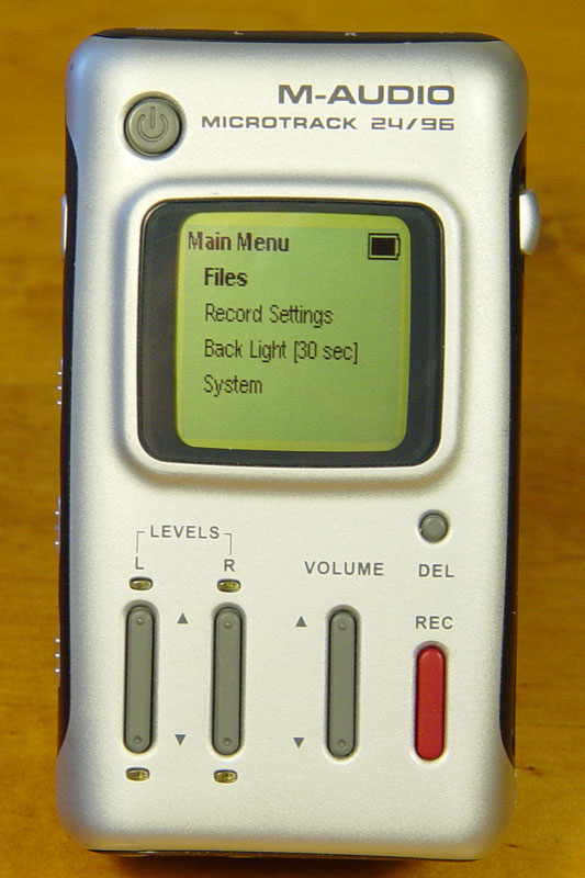

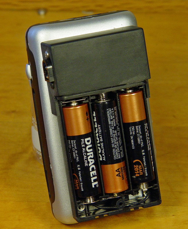

Here's some pictures showing the finished conversion. The battery case mounts to the back half of the Microtrack case with screws from the inside, and covers several holes I bored through while figuring out how to mount it.
The battery case itself has an extension added to the top to hold the external power jack. Adding the extension (cut from another electronics project box) took more time than anything else.
The last photo shows the unit running on AA cells. Note the charge state indicator in the upper right shows a full charge.
