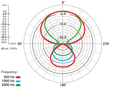

The issue is that while the longer interference tube reduces off-axis sound, it doesn't do so equally across frequencies, and, worse, develops a lobe of sensitivity at the back which responds very non-linearly.
Use it near ceilings or walls, get a reflection of non-linear response. This can be heard very readily if you know what you're listening for. If you don't know what's going on, you may notice that the sound is more "hollow" than expected.

Close study of the polar patterns of your favorite mics will help to tell the story. Below, the polar pattern of the Rode NTG2, a medium/short shotgun. Notice that the off-axis response is different at different frequencies.
