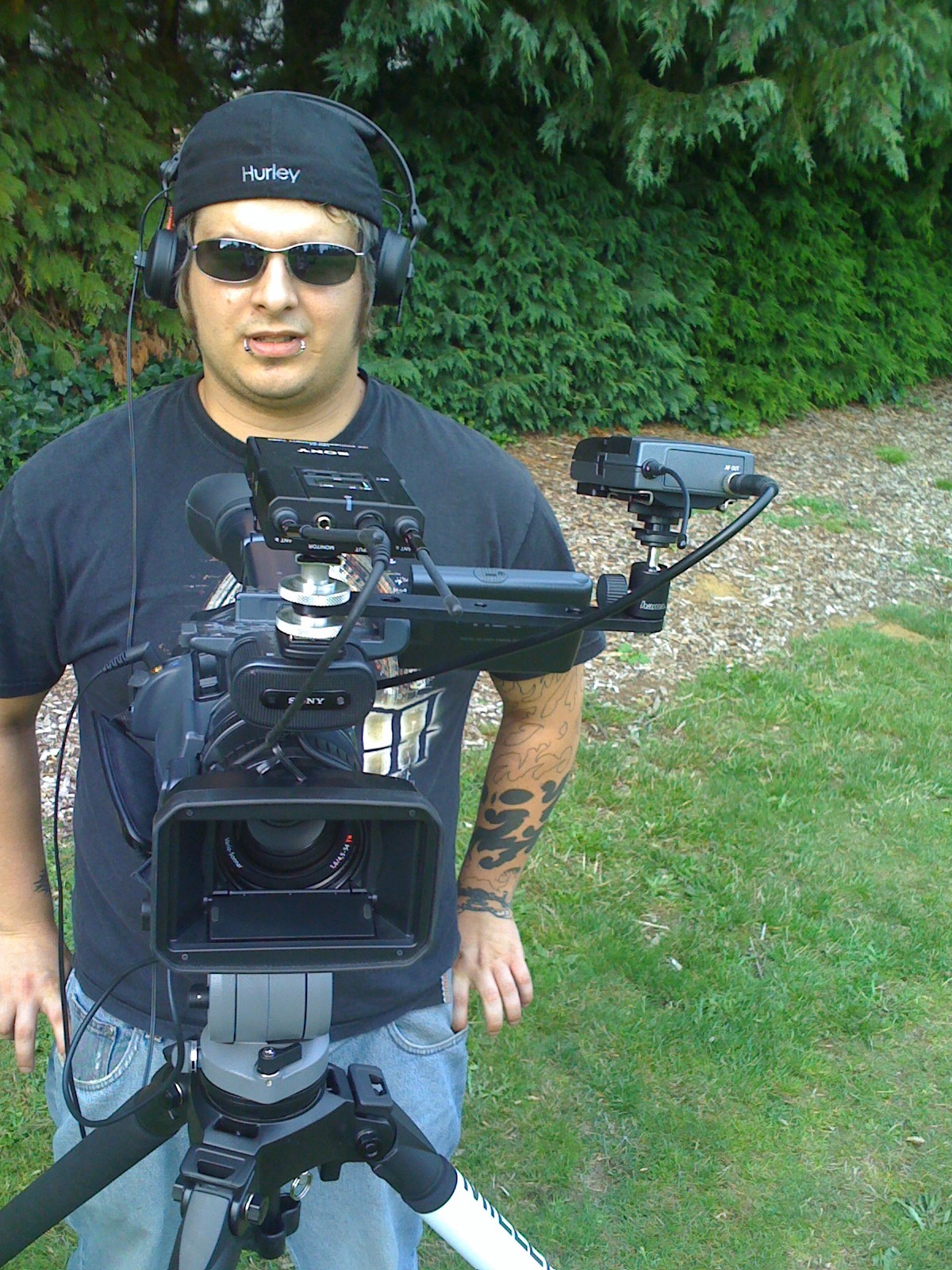

One more less expensive shoe option is the HAMA Delvcam Hot Shoe Mount solution. It has a cold shoe and 1/4-20 thread with moveable ball. Here is a picture from our Sony/Sennheiser range test.
It's tough to tell in the pic, but you can do a full 90 degree angle with the ball head.
