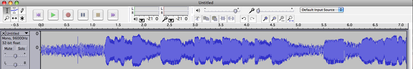

Here's a short sample from the beginning of a sermon. There's a fair amount of background noise - kids and organ motor - he never remembers to switch it off! The Zoom doesn't bring up the level of the background noise too much in the pauses between speaking. It's not brilliant audio but it give an idea of how the AGC2 works.
*5 Attempts later - sorry, it won't let me upload the 2.2 MB audio clip for some reason.
