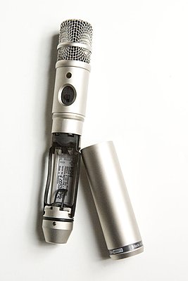

So, instead of the NTG-3, go for an NT3 hypercardioid indoors. It's heavy so take off the outer metal sleeve if you want to boom with it.
Guy, no offence but removing the outer metal cover of the NT3 will greatly modify its polar pickup and seriously contribute to RF (radio interference) pickup, dust and moisture.
Need to fix your NT3 link, it currently comes up as the Format FM600 there ;)

Thanks Allan. Here is the proper link Rode NT3
Just to be sure we're talking about the same thing, the NT3 has a metal body which unscrews to reveal the battery compartment. This solid piece of metal, you're saying, when removed will "greatly affect the polar pattern"? You've tested this?
