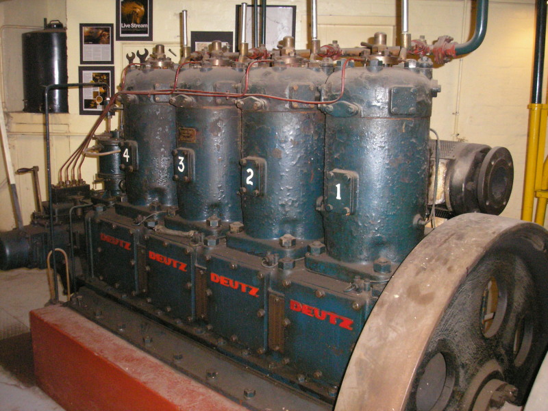

Sorry Jim I missed this. I've been out in the engine rooms of Sydney harbour ferries. You're not supposed to be in there under way without a mask and you can only stay for a few minutes, the fumes are terrific. Also hanging over the stern with the D50 covered up and on a string. I've found for these SFX you have to get close up as possible and let the mixer balance it.
Under the State theatre here they have an actual U-boat engine used as power backup from 1929 to 47. It hasn't run since, wrong config anyway, but very interesting.
