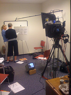

Here's a set up we used last week in a small room... apologies for the pic quality, it was taken on my iPhone camera..
We used a lav on the talent (Countryman B6) - on her lapel, ~6" from her mouth. This was L channel; we then had the hyper on a boom in a cradle on a C stand. This was on R channel. The editor could then choose which sound he preferred.
BTW, the room was horrible, but was all that was available; there was a constant A/C noise which we recorded as room tone and then subtracted in Soundtrack pro - worked surprisingly well.
In the past I have used a mic stand, standard mic clip and whatever mic we had available. This set-up is far from ideal. The mic at that time was a cardioid and designed for sung vocals rather than spoken, however we made do as it was the only gear we had at the time..
If the room acoustics are at all 'iffy', then the lav approach is most often going to yield the best results.
Regards, Ross.

I see you've got a real boom pole there. I don't have one of those... That's why I was looking for solutions.
I am not asserting that this solution will be ideal, or even recommended. I just need to get through this with some reasonable audio.
