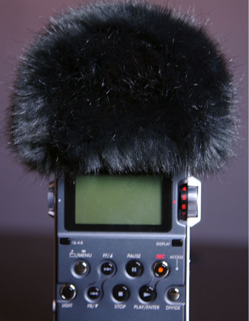

If you get the PCM-D50, take a look at the K-TEK topper for wind protection. It was made for the D50's big brother, the D1, but it fits like a glove on the D50 (as seen below). We have 'em on our site and with the dvinfo 5% discount, should come in at a better price than anywhere else. http://www.dvcreators.net/the-sony-pcm-d50/

Guy, how well do you think that k-tech topper protects against the wind? Would it only be suitable for a normal day or can it withstand heavier breezes?
