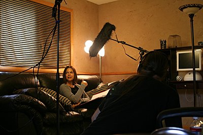

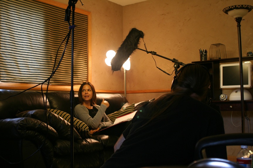

Music store (like guitar center)...make boom mike stands that can get your mike overhead of your actors:
