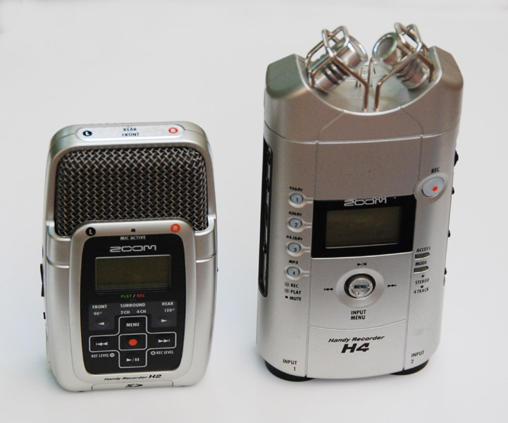

I just made a little web page that has photos comparing the size of the H2, H4, and an iPod nano with a Micromemo attached.
http://www.zenreich.com/ZenWeb/audio/recorders.htm

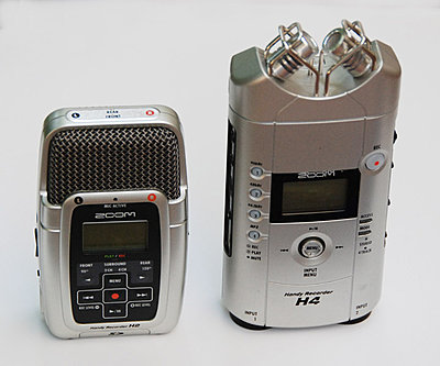

Here's a quick photo comparing the size of the H2 and H4
Alan Zenreich is offline   Reply With Quote
